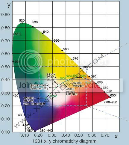

6500K is the beginning of the "BLUE" scale it all depends on how you look at it and from what height. A good blue would be 10000K or if you want like an Aston Martin purple 12000.
Approximate
Light Source K Temp Lumens (output)
Halogen bulb 3200k 1500-2000
Sunlight 5000-5500k
D2S bulb 4100k 3500
D2S bulb 6000k 2800
8000k HID 2500
10000k HID Bulb 2200
12000k HID Bulb 2100
*Note* Those with Projectors every HID system with projectors (not reflectors) will have a color shift in appearance (visible as you approach an oncoming vehicle or as seen by illuminating your headlights on a white wall) there is that line of blue/purple (and other colors, however minimal) that is generated as the light source bends around the cutoff in your projector headlamp. Now, the whiter the light, the more definition of a blue/purple cutoff you will have. So, if you have 4300k HIDs installed, that cutoff that you and everyone will see, will have a significant amount of blue/purple and a little gold, (pink perhaps too) at the horizon... very defined and eyecatching.
