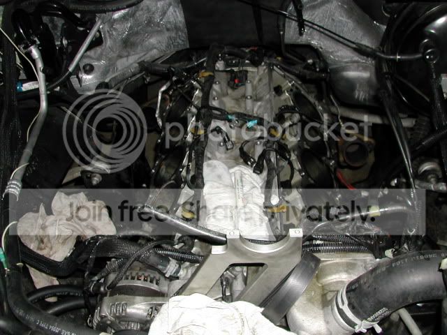

The crank was new already and I only had 3k miles on it since they put a new crank in and once again anyone in Illinois stay away from Schaumburg dodge, the work they did on my shit was 3rd rate if you can call it that. Nothing to spec under torqued. The flex honed it instead of doin it with a ridged hone and to top it off the had it for 8 weeks:mad: So now I am just glad I did the pistons and rods and know everything is put back together the right way triple checked by me and double check by my buddy helping me. :D
Here are the Pics.
These are pics of where you should place the bottle jack on the A/C bracket
to lift up the motor about 6-8inches to slide out the oil pan.
Ill post more When I put the Roe on and if the lazy bug dont bite me I should have her purrin tommorow:D :marchmellow: :marchmellow:

Wow, in frame job huh. Seems like a lot of work in the bay. Is there a reason you didn't pull the block out?
I did it at home, my shop is to dirty for this kind of work. Plus at home no hoist or engine stand. :D I only did rods and pistons so no biggie really.

You say that you honed the motor as well? How did you clean out the block and keep the crap from entering the oil galleries on the throws?
flexhone 320 grit to clean up the crosshatch, if we got shit in the gallies then we did something wrong, I made covers out of the old head gasket with aluminum foil and only had one hole open at a time and we cover the crank with rags.
oh, deglaze the cylinders???
do any head work??????
Yes you technical bastage:D nope left them stock and kept the ring end gap close to stock. I think head work would benefit a turbo setup but it has yet to be proven to benefit an S/C stock cam also. We shall see keep your fingers crossed:marchmellow:
