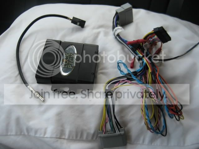

Lockpick adapter and harness from coastaletech

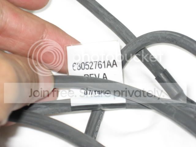

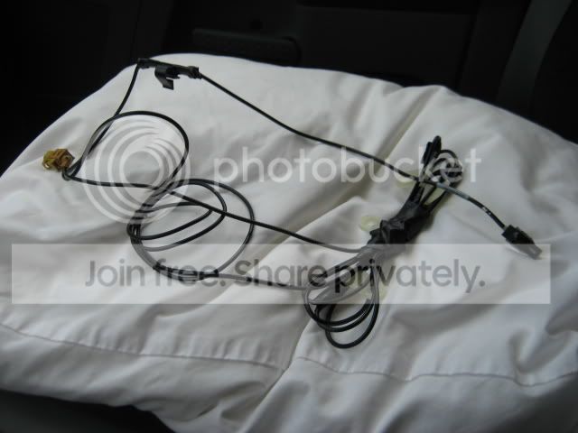

Factory jumper harness for 2009 uconnect mirror to mygig unit

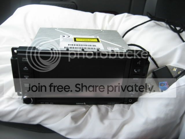

Low speed 30gb MYGIG unit
Factory jumper harness from sat radio antenna to buily in sat for mygig. (bypasses sat receiver that came in our trucks)

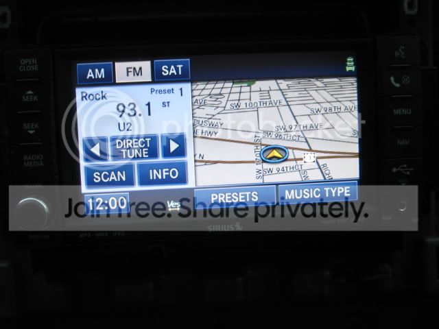

MYGIG playing FM

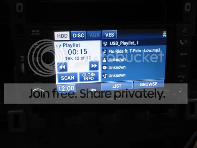

MYGIG playing music from the hard drive

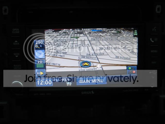

Fullscreen Nav

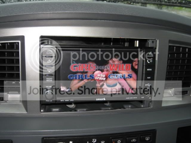

Video in motion from built in DVD drive (oops I thought the Mall Cop DVD was in the drive):D

What I do need, is someone with good plastic fabricating skills to make me an adapter faceplate. As you can see in the last pic, the old REC unit is bigger than the mygig. I ordered some ABS plastic and tried cutting out an adapter using the template from coastaletech's site, http://www.coastaletech.com/media/MYGIG_ADAPTER_INSTRUCTIONS.pdf.
Let's just say, it looked like my 3 year old cut it out using a sawsall. So, if anyone has the skills to fabricate a faceplate, I would be more than glad to pay for it.

The front screen flips down to insert the cd or dvd. And yes, you can use the nav at the same time your playing a disc. The nav maps are stored in the MYGIG's harddrive unit, not on disc like the older nav units. The bezel is from a 2006 Ram with an REC nav unit. That's my only problem. I need to find someone that can fabricate a faceplate to fill in the gaps
