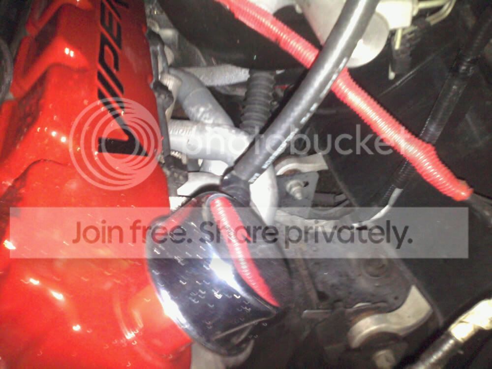

can ya post up some photos????

Ill take some now and post in like 30 min. I think you are correct about the booster.

#1 take that valve cover breather off oil fill hole,,and take it off catch can ,,that thing is blowing right into your brake booster vacuum line ,,that hose going to brake booster take it off, the one thats rigged up asap ,,dont know why it is like that,,get a normal cap ,,
:dontknow:
the roller rockes will sling a little oil up into that breather ,, i have harland rollers and they dont stand as tall as yours ,and mine will sling it out hole if i leave cap off
you should have one line from left and right valve cover, tee,ed off ,and one line going to catch can, and i would bet money they took your baffles out !

ok after watching video ,,looks like can is right but that breather and line going to booster vacuum line needs to go ,,surprised your not having brake problems

looks like you have a jumper hose going from one valve cover to the other on the back ,,then you have a hose coming off breather that goes to catch can ,,,YES??

does that hose go to catch can or booster hose ??
(booster)
Should i put a filter on it or run it to the can as well?
sim333 said:
(booster)
no booster should be hooked to booster only,,,that rigged up hose coming off booster were do you have it hooked up to ?????????
