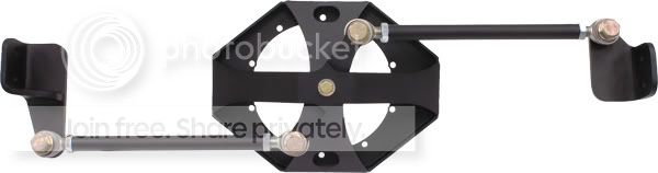

This is what I'm considering. It's designed for a Chevy but will work on our trucks. They'll send the kit with different brackets that would make it work. You would have to use a fuel cell if you mount it inboard of the frame. This will allow you to run a 16 wide tire. In my case, I was looking into the Pirelli 405/25/24's.
This setup would not work well on our trucks as it will not transfer the weight and you cannot set an instant center with it.
your gonna need HD links that will withstand the trq of our trucks , the ones from such as air baggit will not work they will fail quickly,
it will have to be a custom set up
