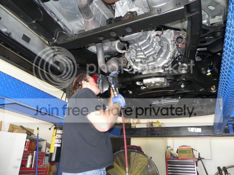

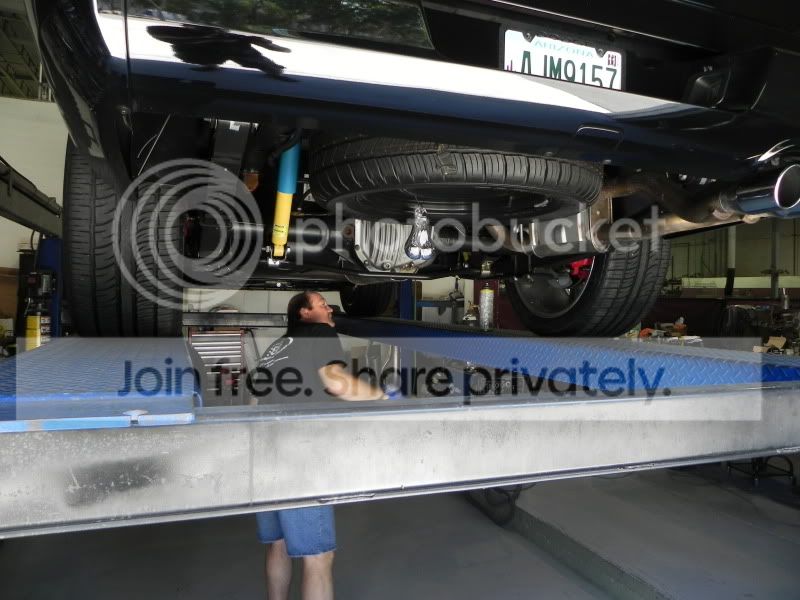

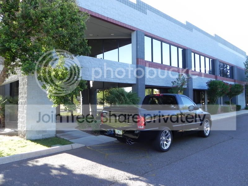

My arrival at the facility around 7:45 a.m.

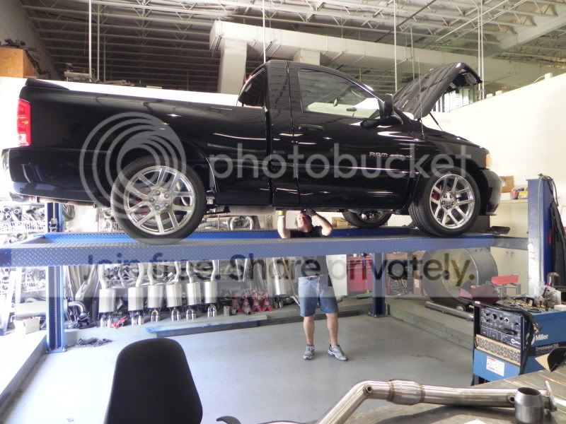

Eric who in in charge of operations met me in the lobby and after a short wait, directed me to pull into the installation bay.....

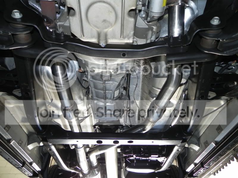

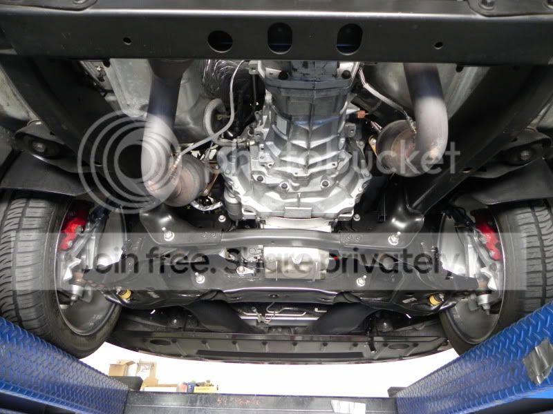

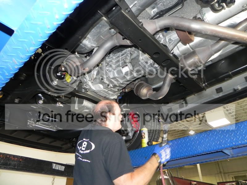

He goes over the whole stock exhaust system with me and points out where all the restriction points are......
Time to start removing the stock system.....

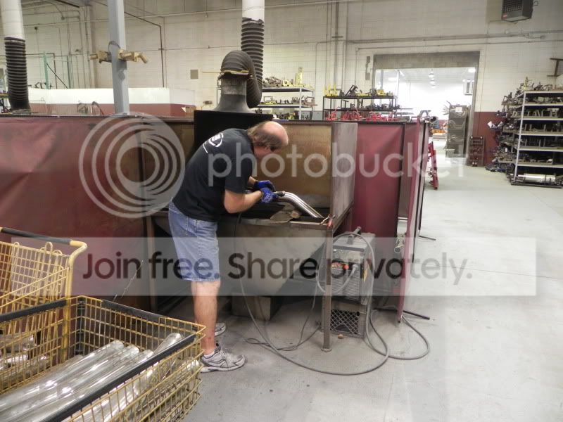

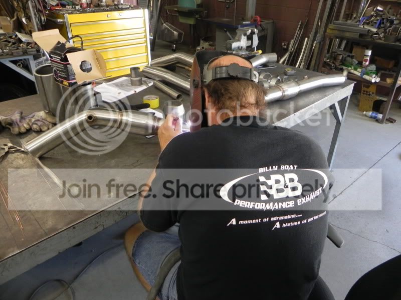

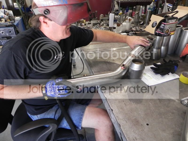

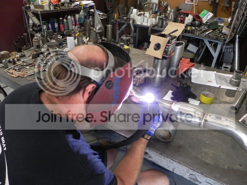

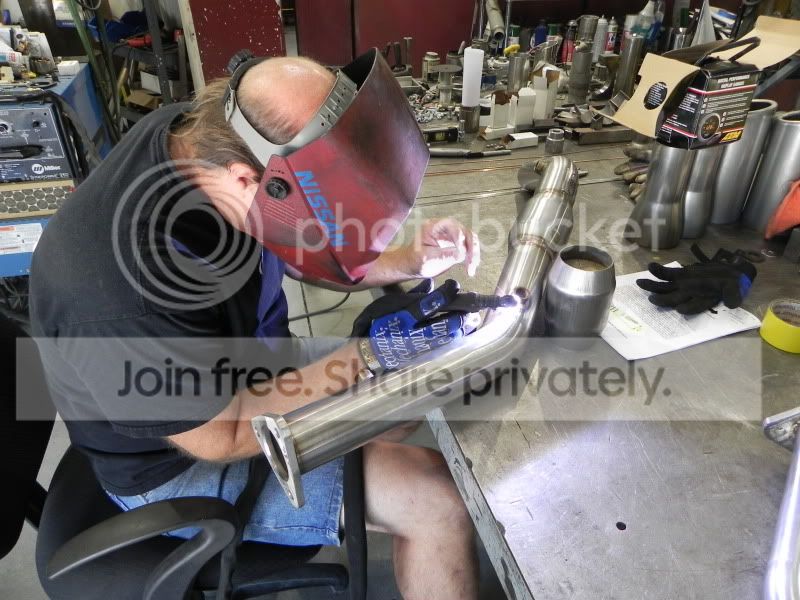

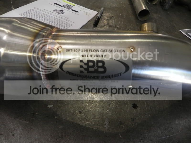

Eric is also in charge of R&D, which includes Dyno tuning to ensure that Billy Boat Exhaust provides the best fit and performance. In the next few photo's, Eric custom fits my midpipes with Eastern Hi Flow Cats and the nessessary bungs for O2sensors and my AEM Wideband sensor.......
Here is a close up of the buisiness end of a Eastern 3" 200 cell metalic foil Hi Flow cat....

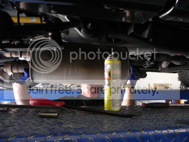

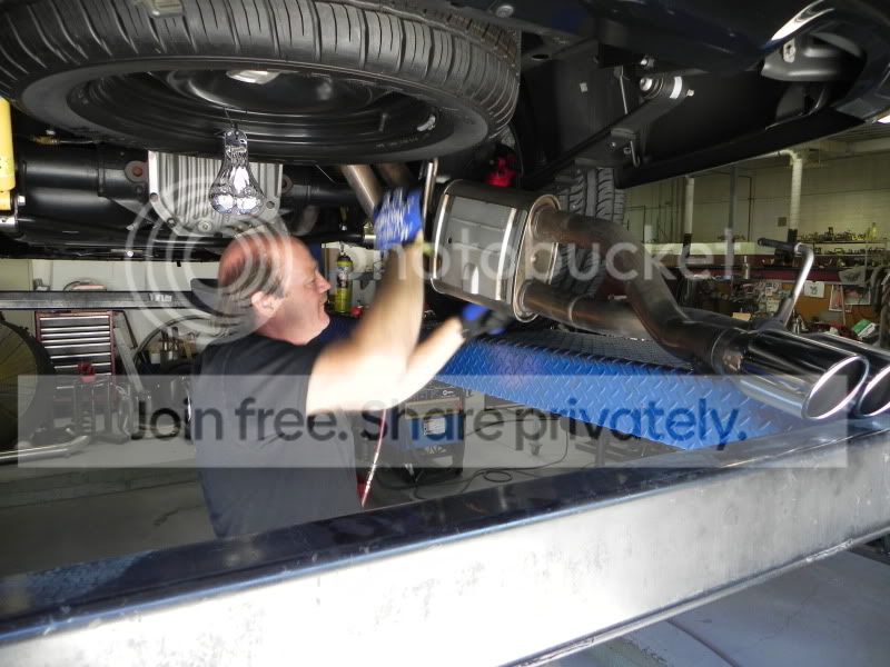

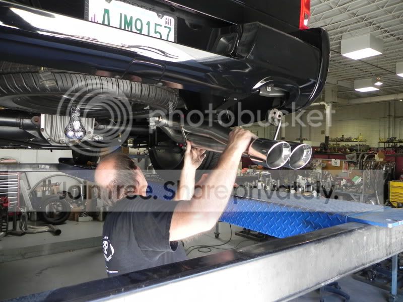

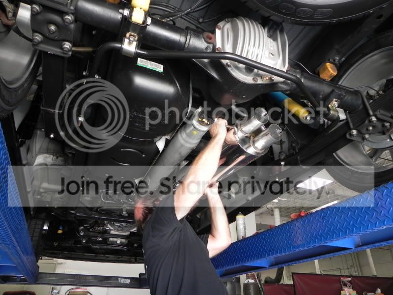

Once the midpipes are placed, the beautiful polished Stainless steel muffler goes on.....

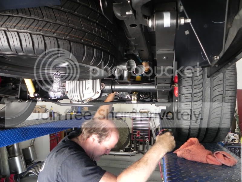

Then the tailpipes are carefully placed.......

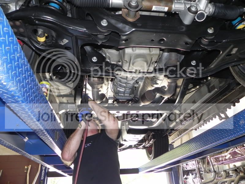

Finally, everything gets checked for clearance and fit before tightening all the fasteners and clamps.

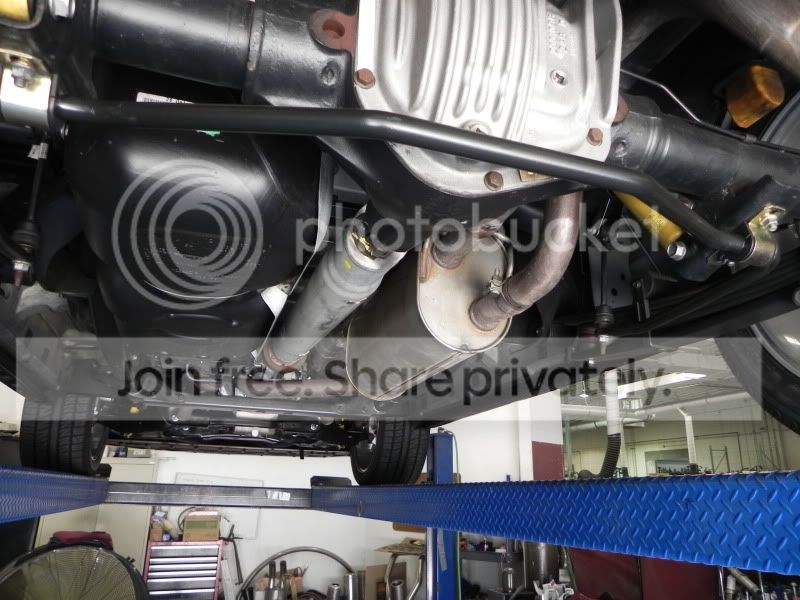

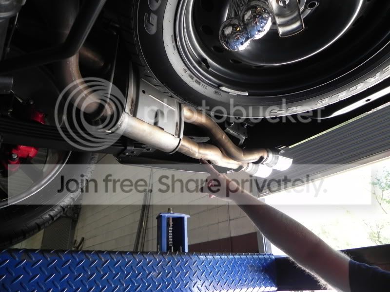

Here are the before installation photo's.....
Note the yellow tape used to protect the starter cable from being grounded out.....

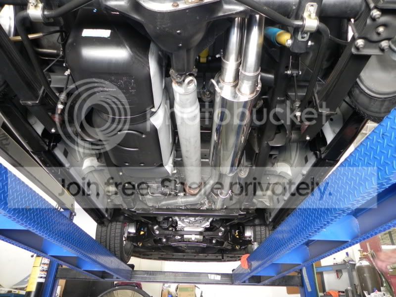

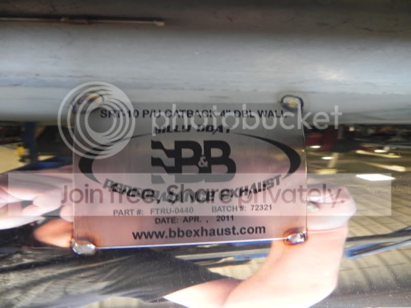

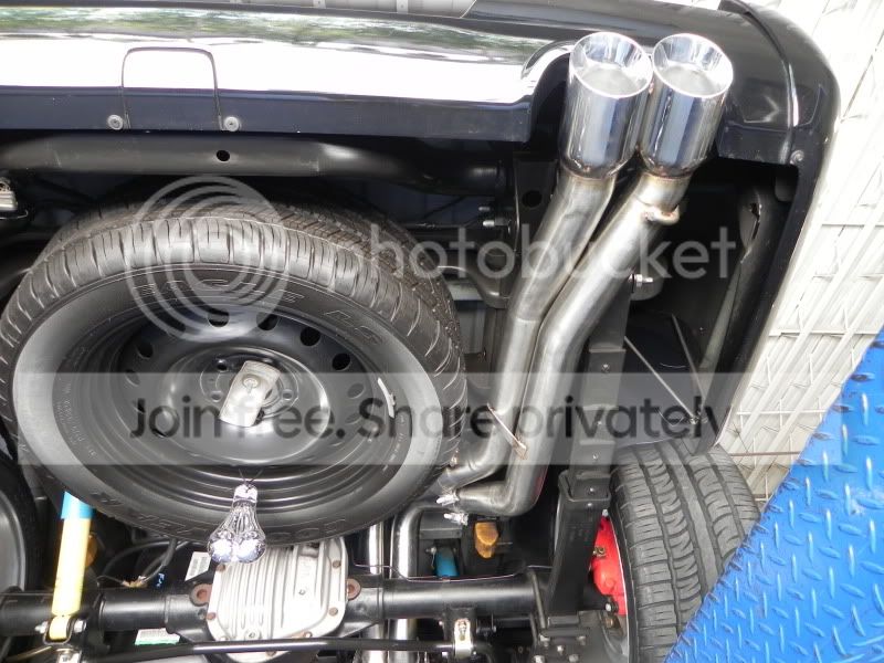

And this is the after photo's of the full 3", manifold back, T-304 stainless steel, hi flow cat, dual 4" tipped exhaust system......
Needless to say, this system makes a dramatic difference in the trucks overall sound. B&B's muffler design (which I will cover in my next segment) keeps most of the sound out back and keeps droan out of the cab. The deep, rich, robust sound mimics that of any 500 ci big block engine with just a touch higher tone and NO obnoxious, raspy snap!! Truly awesome!!
Power? B&B claims 39 h.p and 46 ft. lbs. You can definitely feel that extra power through the middle of the powerband.

You got a lift at home to clean the underside of that truck?
oh, nice addition to the spare tire.
very nice setup and damn, the underside of that truck looks brand new. Whats your secret? you got 50 mexican kids working for you? lol.
very nice setup and damn, the underside of that truck looks brand new. Whats your secret?:aetsch::aetsch: you got 50 "LEGAL" mexican kids working for you?:itsme::itsme: lol.

glad to see that B&B got rid of the flanges & went slip joint:rock::rock::rock:
fuel mileage should jump up also. i know i know, just what happens when ya let her breathe out her butt:aetsch:
does B&B's muffler act as an H/X pipe????:dontknow:

Nope! Jack Stands and a creeper with crappy old rags on.
Yeah, the addition does crack a smile or two! Every billy bad ass bulldog should be show'n a pair!;)
As all have already said that is the cleanest under body I have seen on any truck. The B&B's just add to it. How many miles do you have on it? I will setup a local get together soon.
