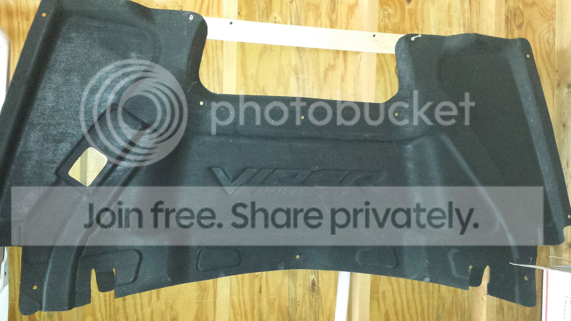

I just took mine off. Had this painted on instead...

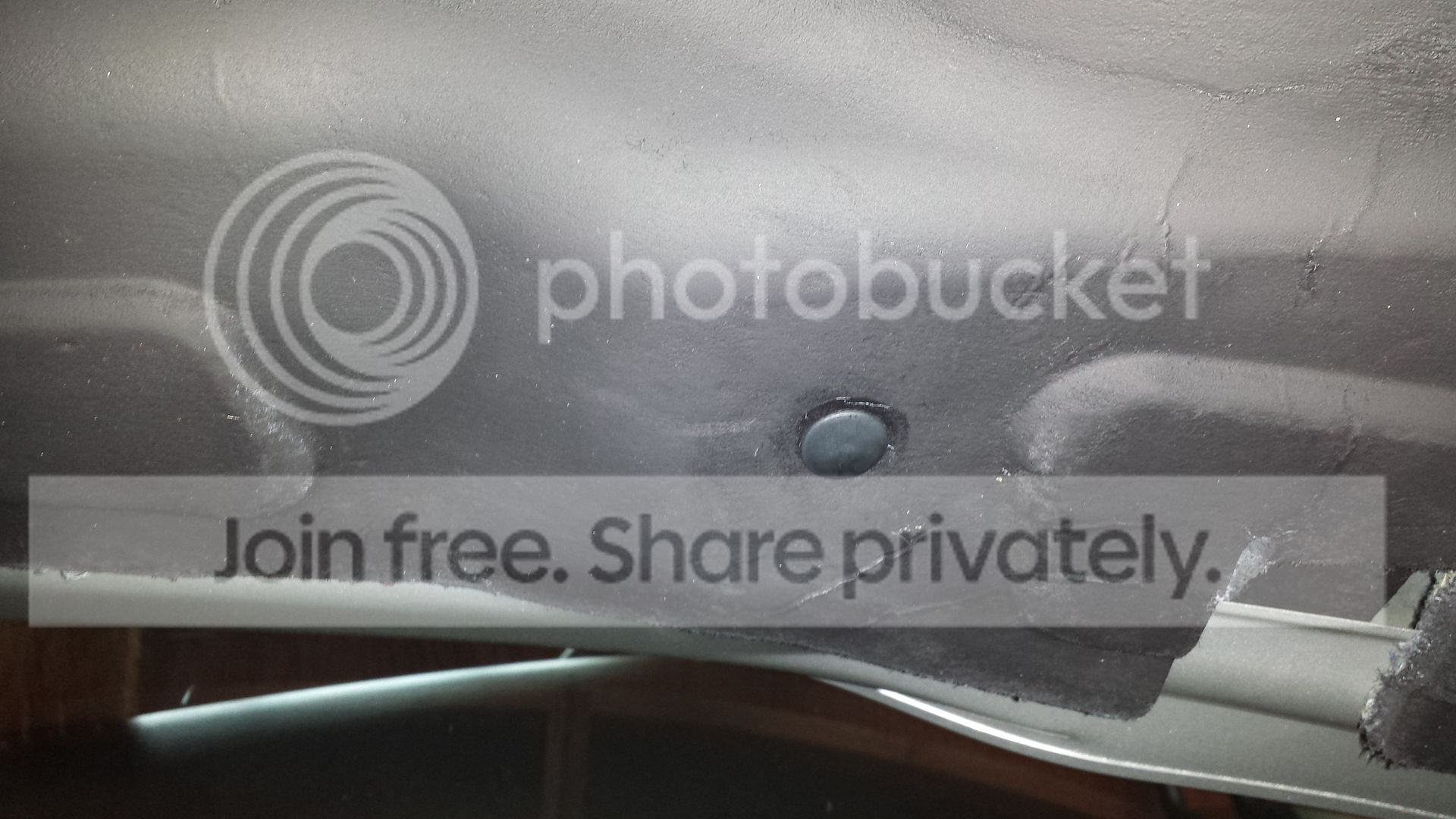

I ended up getting it at a discounted price anyway, then i experimented on it some. I figured what's the worst thing that could happen, right?
Painted the whole thing with about 6 coats of filler, sanded with 220 between coats, and then painted it with flat black, and painted the letters silver.
Surprisingly with every coat of the filler i was able to sand it smoother. It actually turned out really well.
Painting the letters was a snap. No bleed through at all.
So far so good for durability. Ive had it on there for the whole summer and it still looks great!

Would the filler primer provide new rigidity to a sagging hood liner? May be worth a shot. Might need the hood off to provide the proper "form" to the liner though.
Id just take the liner off and hang it for awhile. My old one straightened out on its own.
I think the key to prevent it from sagging again is to use some body tape to help attach it, and drill 2 extra holes in the hood for extra clips where it normally starts sagging. Just to the inside of the "felt" tabs on the rear of the liner.

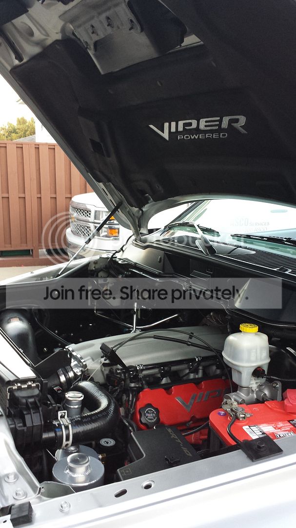

Another pic
Shawn Ealy Designs...! $1300 That included the bottomside of the hood prepped and repainted black and the fixing of my scoop insert. Shawn was here in Illinois for a bit then moved back to Cal.(I think). I got lucky...lol
