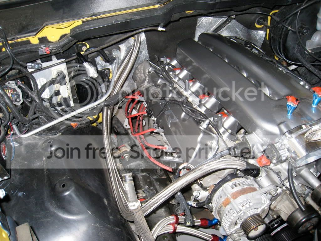

    IAC (Idle Air Control) is the do hickey that is to the passenger side (right) of the throttle body. It has a hose that goes to it and not sure where the other end goes at the moment as I eliminated mine a long time ago.
    The purpose of it is to ensure a stead idle speed no matter the conditions (temp, altitude, etc)
    To eliminate it is really easy. Take a hose (about 3-4" long) and put it on the nipple, then put a big bolt in the end of the hose to block it off. This is what I temporarly did with mine to get it to run on a factory tune with my camshaft (it doesnt idle so good). Then you can adjust your idle speed by turning in the setscrew on the throttle body.
    In this picture look just below the throttle body and you can see some red tape blocking off a nipple. This is where the IAC is.
    [​IMG]
