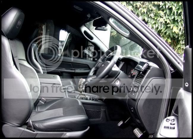

Most of you won't know that I'm close to selling the Batram but may consider keeping it and using it more with an auto PLUS a Supercharged set up - built right. I'd like to aim for around 750-800hp. As it stands I just don't drive it enough, maybe 1-3 times a month if that. I purchased it as a daily driver but it becomes a pain in the arse in daily traffic, plus I'd like my Dad to be able to enjoy it if he wants to drive. Being in his mid 60s now he is over the stick days and prefers it easier but in short I think it'll be a cool and very unique setup, fun, fast and different.
I would have it floor shifted with the works, manual valve body etc and a beefy QC transmission, as far as I know? (hence this thread). Anyhow, feel free to mock all you want lol you don't have to drive it, I think it would be sick, be a meaner street machine and be a fitting set up for the Black Knight that the truck is, plus rid a lot of the RCs issues in the 1/4 mile. It's this or sell it for an SRT8 Jeep and I just can't let the looks of the Batram (and SRT/10 RC trucks go) not after all this effort and time. The RC front end is no different is it?? The QC is just longer at the back and has two more seats so it shouldn't be any difference?

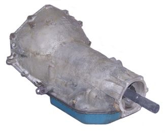

i wouldnt do it with the 48 re i would do it with a turbo 400
I would as well. I dont think the 48RE is strong enough,reliable enough, or even capable of causing neck snapping, consistant shifts like the Th400.
http://www.browellbellhousing.com/
Can make you a custom bellhousing to bolt up to the viper engine.
Being it is Throttle valve controlled you dont have to worry about the electronics.
You will need a custom crossmember that is easy to fab up, and a driveshaft.
But i well built Th400 would be the route i would take.
i have heard that there is an adapter for sale for the th 400 for our motors

I'm currently changing my QC to a TH400 with a gearvendors behind it. If anyone wants to convert a RC to a 48re I have all those parts (other than adapter and computer)... flexplate and hub, suncoast tranny and torque converter, column shifter.
That said, if I had a RC I'd go with a TH400 and gearvendors. You wouldn't have to change engine computers and harness, just need the tranny, adapters, driveshaft, crossmember, shifter. Here's where I got everything for mine.
Tranny: Mike's Transmission in Cali. www.mikestransmission.com This is also who Jack got his through. Great guy, understands what it takes to make one survive in a heavy vehicle. He also did extra machine work once he got the adapter on to make sure all the spacing was perfect in relation to the torque converter.
Adapter: Donato Engineering. He has everything you need and the stuff is truly top notch, albeit a bit pricey.
Gearvendors: www.gearvendors.com Mike supplied this with the transmission.
Just a thought, don't the QC and RC have different engine blocks?
Wil
Yes but the company I listed above, Donato, has adapters to take care of it. For instance.
QC to TH400. Use 02 Viper to TH400 adapter with 05 flex plate.
RC to TH400. Use 04 Viper adapter and flex plate.
He also has the adapters for dodge trannys on viper engines.

This sounds like the best way to go Carl, If the 400 ever needs rebuild, it would be cheap...You can get manual valve body, any torque converter you might want even a trans brake.:rock: :rock:
