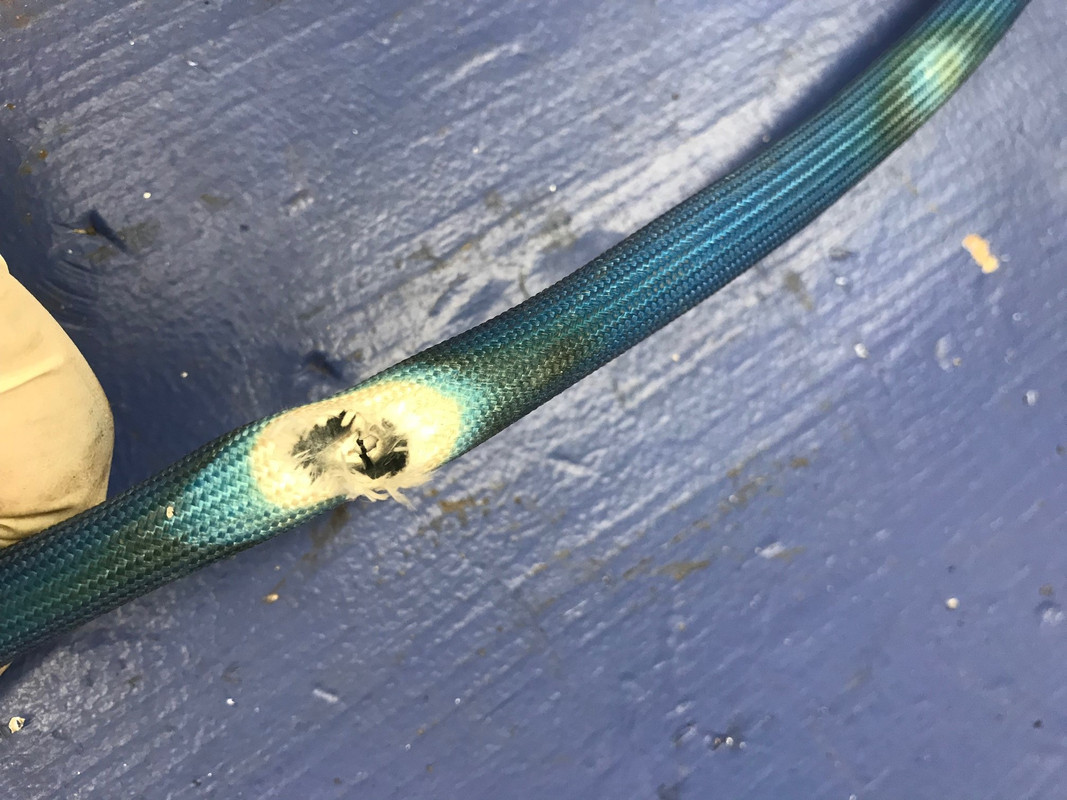

    OK found the problem.
    The wire was TOAST! Must have drooped onto the header somehow.
    [​IMG]

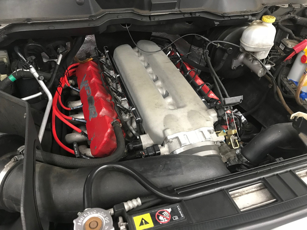

    Sure isn't the easiest vehicle to work on. Ive got long arms and most of the time I was laying on the radiator support.
    Out with the old!
    [​IMG]
    In with the new. Fired right up and runs perfect. 104k miles
    [​IMG]
    Thanks for everyone's input.
