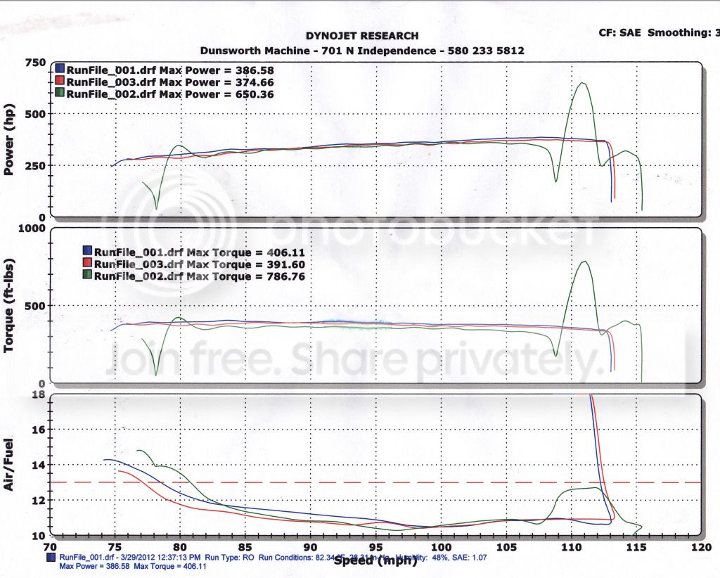

    Sorry for taking so long guys, my girlfriend had her baby last night so I have been preoccupied lol. After driving an 1 1\2 hours to the dyno and just putting it right on the rollers here are the numbers: 386 hp and 406 tq. I will post up the graph in a little bit but she was definitely heat soaked and running pig rich haha. Overall I think it's a good starting point! :D

    Well after much delay here is the dyno graph on the beast. :D

    I was at 389 (stock) on a Dynojet with my QC.
    You NEED a performance tune from DC Performance in Los Angeles.
    It is by far the BEST and cheapest performance mod for a Quad Cab.
    You'll pick up EIGHTY in Torque with a performance tune.

    Looks like you are under 11:1 for over half the powerband. (too rich)
    More to be had from a tune like Ronnie said:rock:

    I had previously read that these trucks were way too lean from the factory but the graph says different lol. I sent the graphs off to Torrie and he is writing a tune for the truck along with the other mods I have purchased I hope it wakes her up. :burnout:
