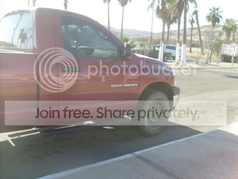

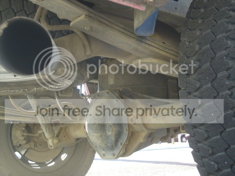

Hey stink, remember when i told you that the 2500 trucks built in mexico had what looked like dana 60's might have smaller brakes...Well here are some pics I took of one when I was down in cabo.. But the brakes look like they are same size.
