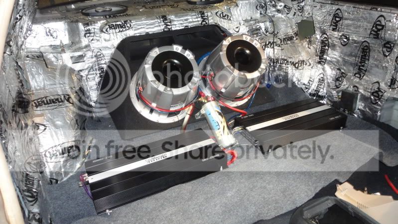

Two Rockford Fosgate T2's.
Sundown Audio SAZ2500D
