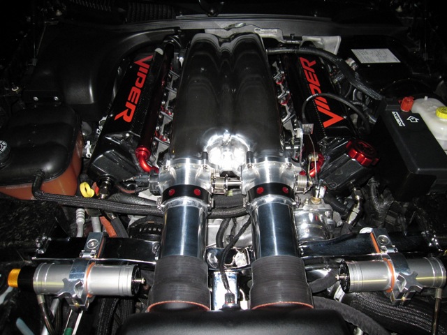

Two piece, twin TBs, great plenum volume, runners are clean, beautiful stock intake.
Incorrect, this upgrade kit for the Gen III does have a two piece manifold, but it will accept our stock throttle body or the BBK or the JTSVenom TB, which are single twin blade tb's. The Gen IV intake for the cars do have twin single blade TB's drive by wire, this conversion still uses a throttle cable.

And a few other gotcha's .. Those are GenIV heads, the exhaust ports and bolt patterns are different so headers / exhaust manifolds and such become an issue as well.
For that kind of $$$ you'd be better off with a set of striker heads and a cam, and make as much or more power.
Good info, never looked at what did on the intake for the truck application. Your build should be awesome

Sorry though, this is more of a teaser than anything, we currently cannot accept any new orders for this as all current stock is tentatively spoken for, and build slots through summer are full.
What did that car end up putting down Dan?
That car made about 620 to the wheels, heat soaked, 80 degrees ambient. It was our mildest available camshaft as well, even passes emissions.
Building a Gen-2 version right now, with a bit larger of a camshaft :)
