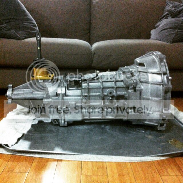

Thanks gents. Now it's just installation and getting that driveshaft in as I will be borrowing E's in the meantime.
