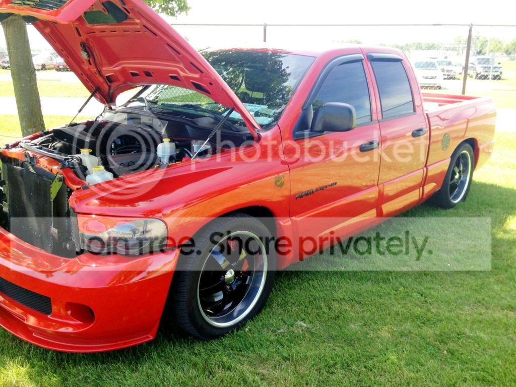

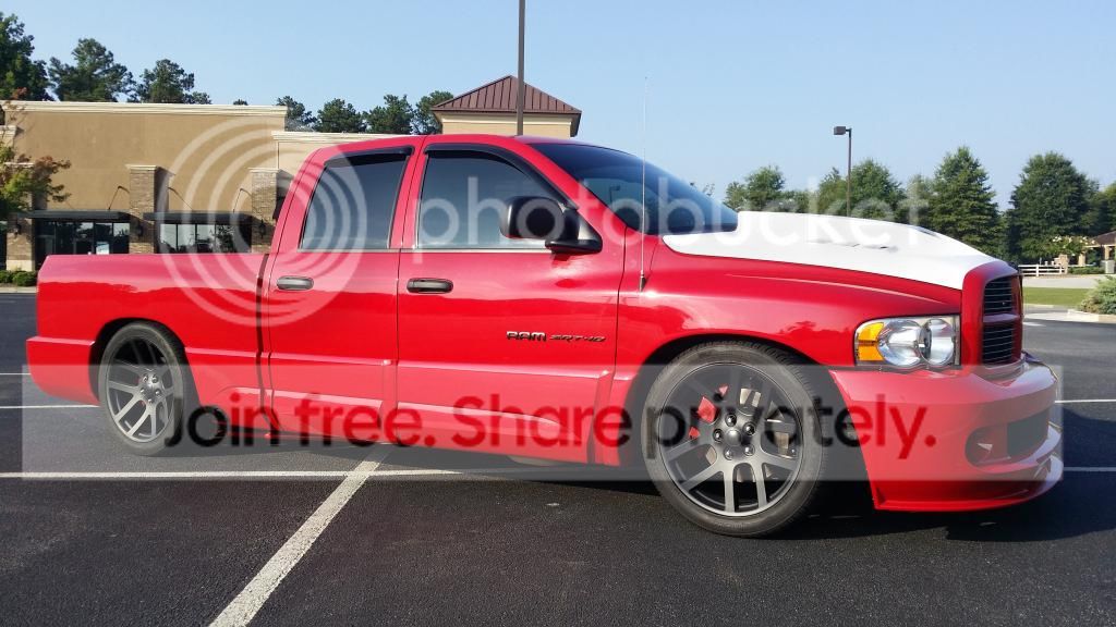

2005 SRT10 Qc 82k miles. I bought the truck with 69k miles and mods were t.b., cai, tune, side exit exhaust and 6spd conversion, after market wheels. Since then I have done a custom drop, C-notch, Qa1's, bumpsteer kit factory blk wheels, SS hood, JTSVP gen2 shifter & knob, JMB battery relocate. This truck is also my dd which hasn't had one problem with minus the reverse which was messed up when I got it. Truck got into a minor fender bender in a parking lot which I am getting paid for so time for some paint and mods in the next month or so. Have to do these quickly as its my dd.
Mods being done are:
BODY
Fresh paint, mesh grills, rolled fender & bed lips, Calvue mirrors, painted door handles, wing, blk out heads & fogs, debadged, fresh tires and wheel color
DRIVE TRAIN
MMW uca mounts, MMW custom upper control arms, ball joints, 1/2" drop all around, Caltracs, Qa1 kicker shock, Rc rear sway bar, MMW watts link, shock extenders, fix tranny, possible new clutch, JTSVP hydralics, JTSVP oil & fan lines, JTSVP wires & coils, Sct tuner, JMB complete fuel system, paxton blower with custom air to air intercooler, new exhaust system
All parts I have or ordered waiting to get. Will be posting pictures as it goes

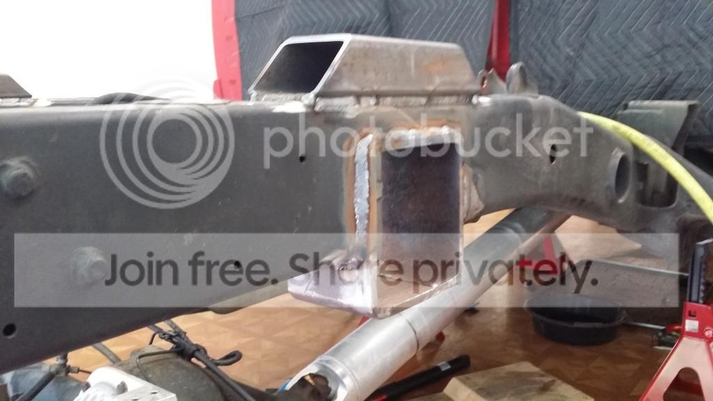

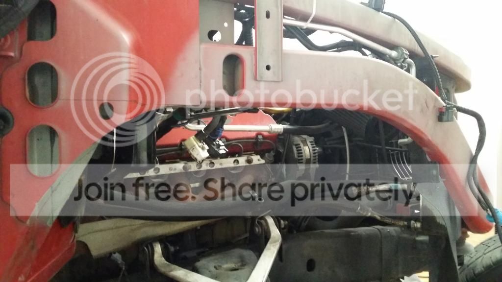

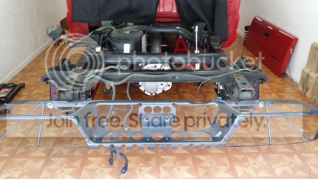

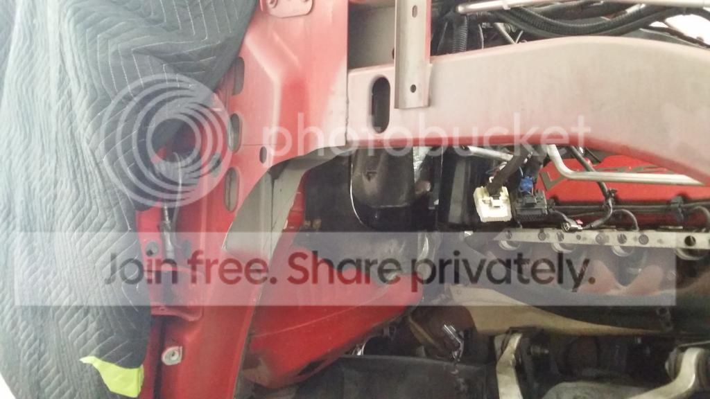

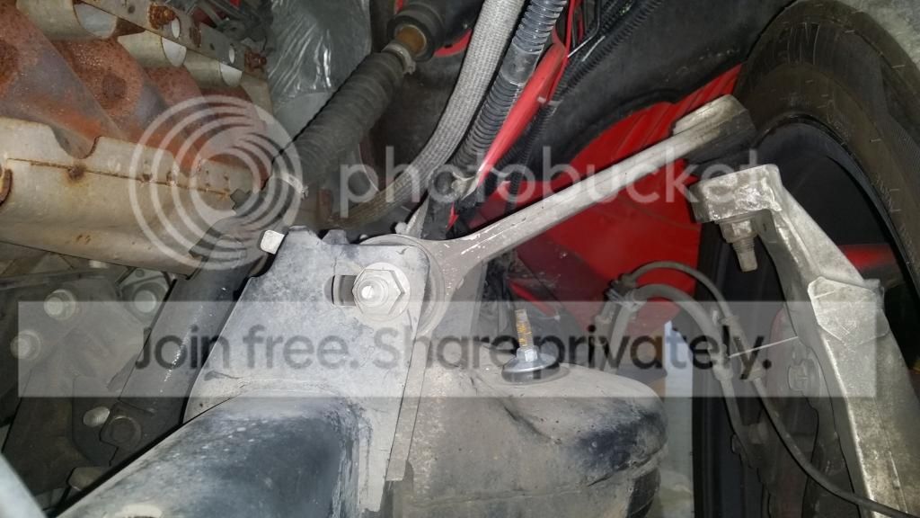

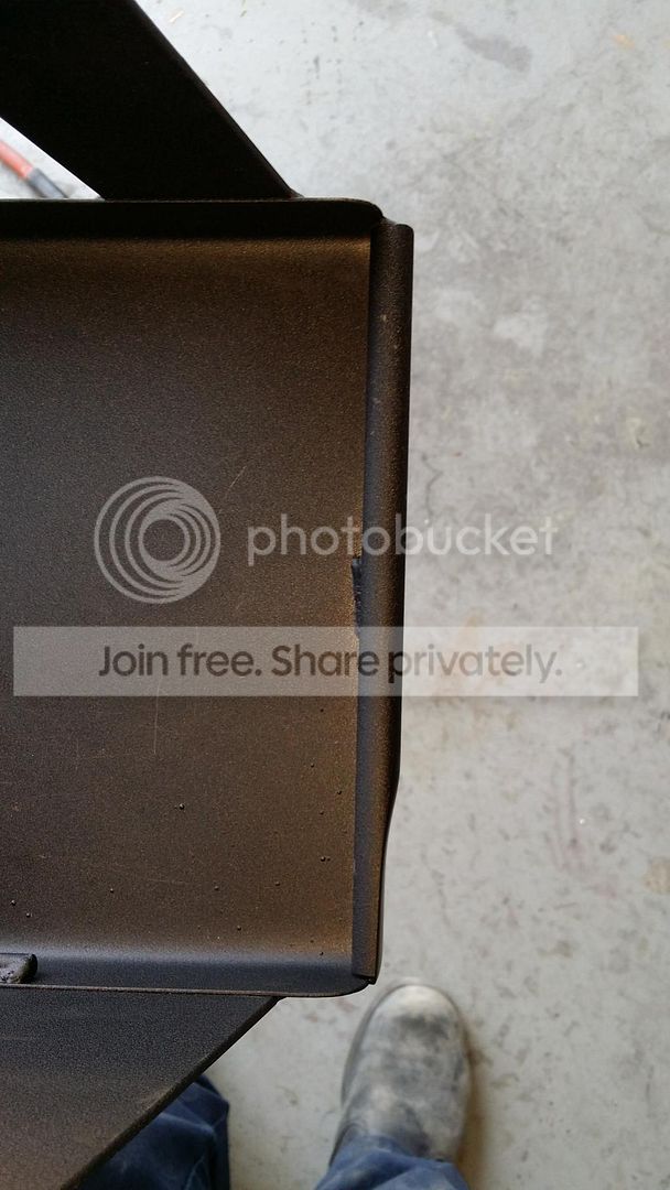

Had to cut out for clearance for front wheels
I also had to cut and reposition the ecm and brkt. Can't use cai box either. For the time being I hacked up the fender liners to move them up and move them higher.

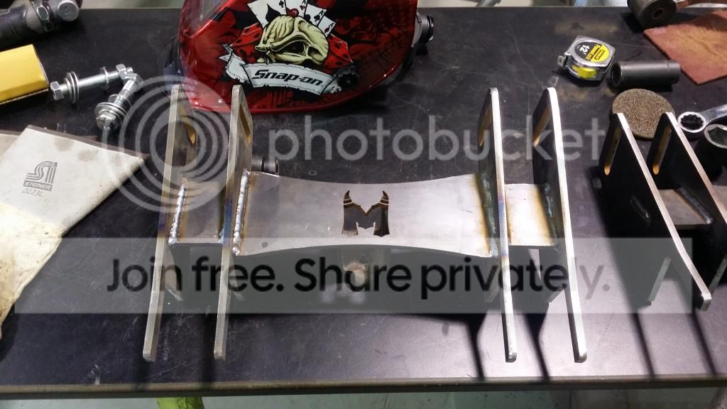

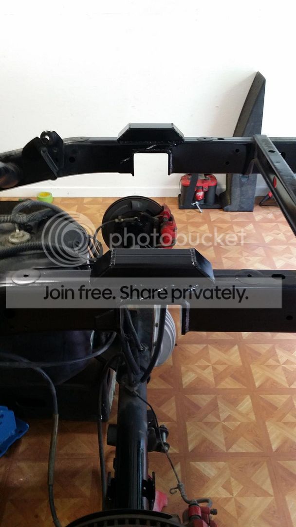

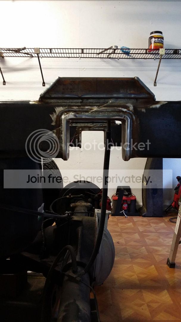

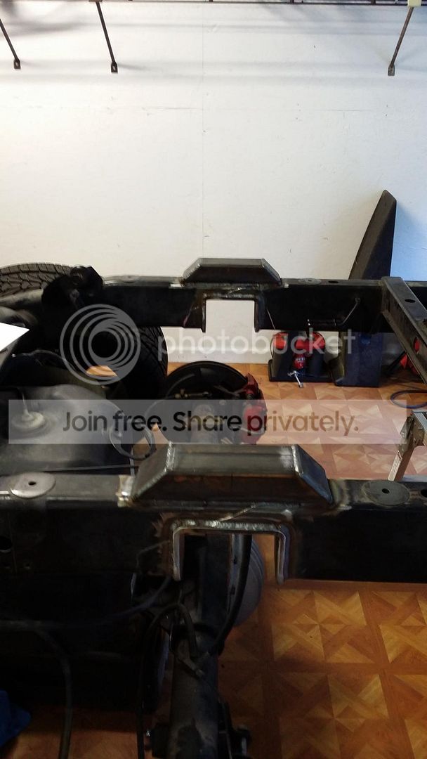

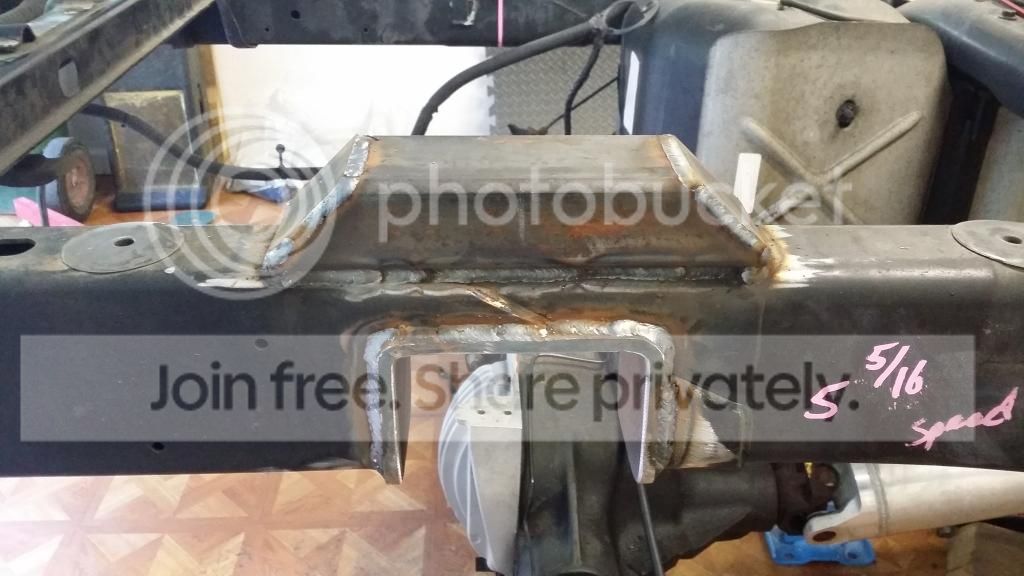

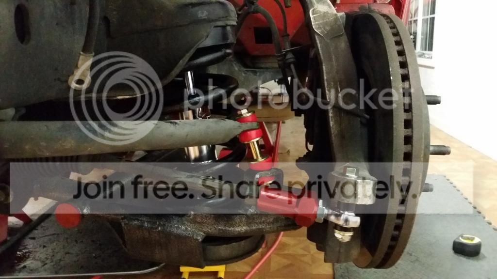

This is one of the issue with going low is the extreme angle of the upper control arm. I have ordered new mounts and arms to fix this issue.
You can see here how much higher the mounting point will be
All welded up

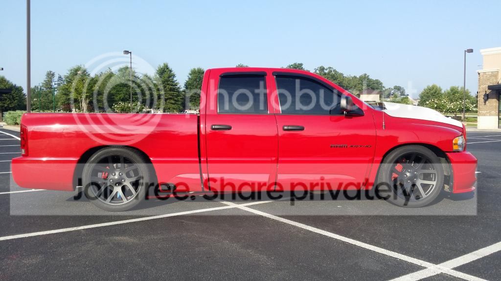

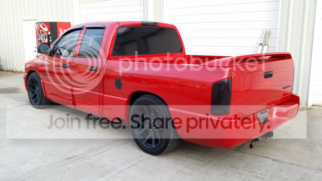

I still use it as a truck for sure. I made sure that even with my drop that it can still be used.

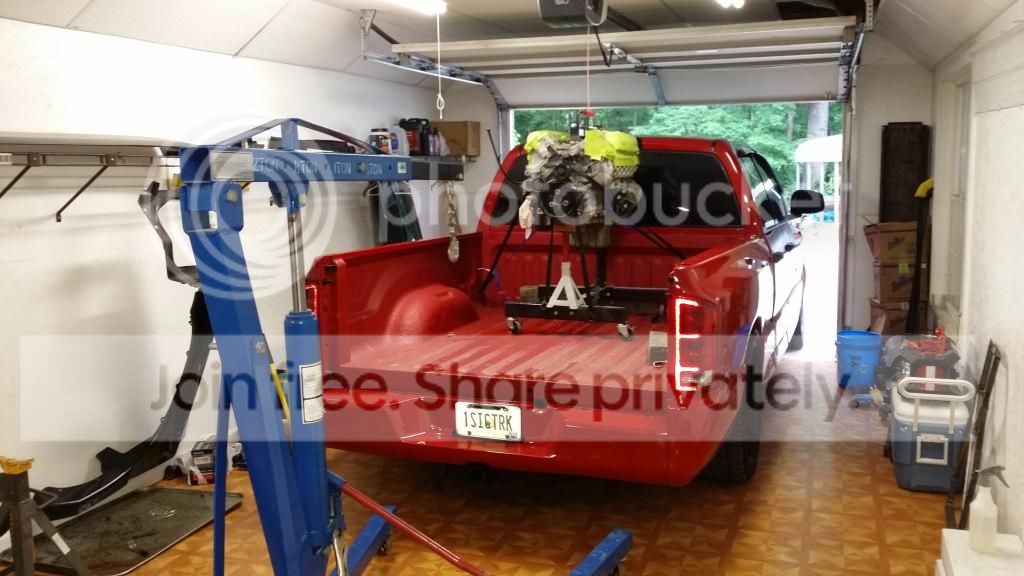

2 viper motors In one truck lol
Amazing work man. Those new upper control arms look good, nice and chunky!
That is an awful lot of work to go another 1.5" lower than mine.
