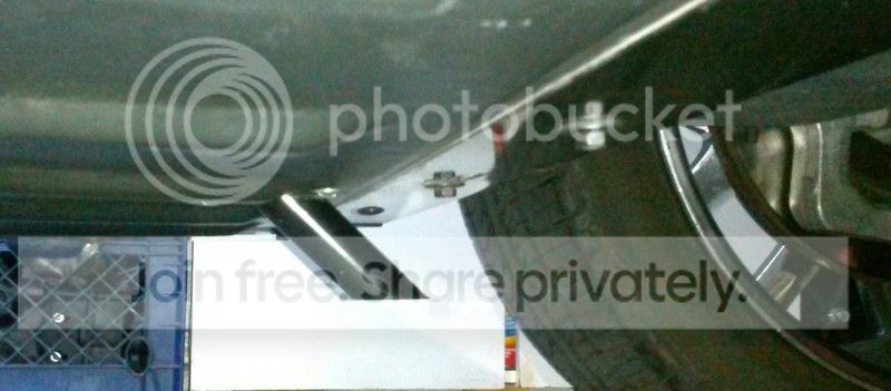

I run 2 Moroso cans, both mounted to frame rails.
Each can has a petcock to drain underneath.
No issue with smoke/smell at all.

I have a small JMB catch can mounted on the front cross brace and the line pretty much goes down from there. The end sits next to the filter behind the A arm.
