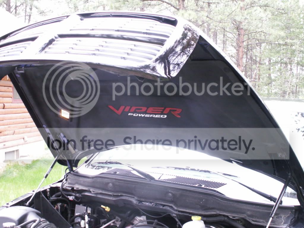

Finished the hood liner

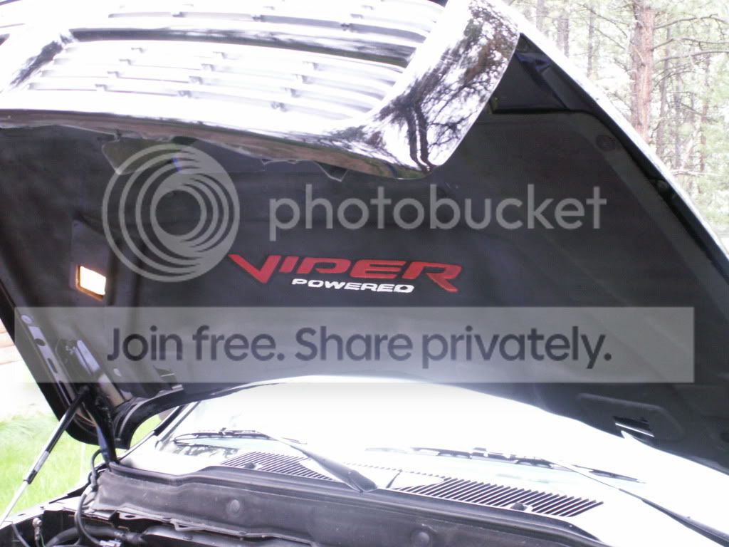

Well, the paint dried. It looks OK. Sure don't look "custom". Have to think about something else when I win the lottery:D :D :D
Fixed the light while I was at it. Sorry about the sun glare.

I like it!!!!!
Yellow venom said:
Looks good,what kind of paint did you go with?
Flat black, high temp engine enamel for background, true red and white fabric paint for lettering. Started lettering with an oil base paint but it soaked in too fast, despite all my sealing and primer and etc., and would have required a bunch of coats. Santeen and a couple of others did theirs with fabric paint so I went down and got some....the instuctions say to "iron it on after it dries" so I just took my heat gun to it and rubberized it :D Maybe it'll stay put for a while.
