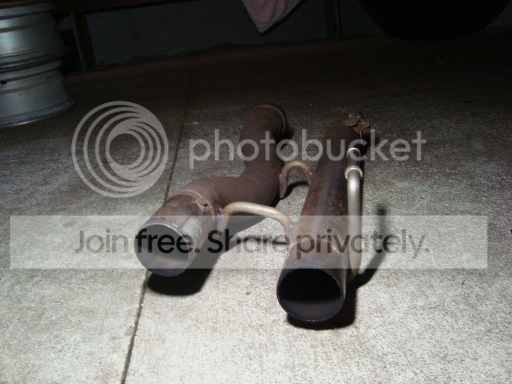

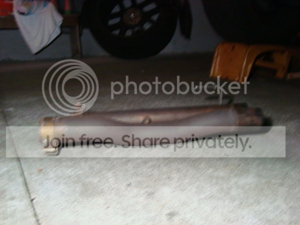

Yup, you'll probably end up running lean without it. Go with oem metal exhaust gaskets instead of the felpro ones that come with the belangers. If you go with a sct it can delete the rear o2 sensors, just zip tie them up under the truck but still leave them plugged into thier harness'. If you plan on going with the belanger catless mids and mopar/borla exhaust, you will need to reuse a small section of the stock exhaust piping or do what I did and have a small section fabbed up.
This is the section you have to re-use or replace if you have a quadcab and want to connect the belangers headers and midpipes to the mopar/borla, not sure of the other catbacks.
