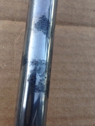

I have a set on my CE, havent driven it yet but i was a little disappointed as the 5th shock has rust on the shaft.....
Not just surface rust but really deep rusted spots.
Never had that on QA1 shocks.
No way. Billet aluminum doesn't rust.
Not sure yet, will send an email to Tony and JRI.
i bought them used, not blaming the previous owner as i know he really
takes good care of his car and truck.
It was installed as it should be and in the end its just a kicker shock.... (Very expensive one btw)
Lets see what the reply will be.
The look of the other 4 shocks is like new, no rust at all (as it should be)

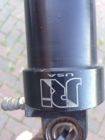

there worlds above most else, they actually build the same for the vipers, and the dodge race teams, including the viper 24 hour team, its not a dual baffle oil charge like most others. have any questions call

I warranty mine personally thru the original purchaser for a year, but we work so much with JRI, if you ship it back I can more than likely get that taken care of, we could have it checked out to see what exactly happened in that situation.
Thanks Tony,
appreciate your reply, would have sent you a mail anyways.
I could ship it to you and you can have a look at it and talk
to JRI. Its probably only the shaft that needs to be replaced.
