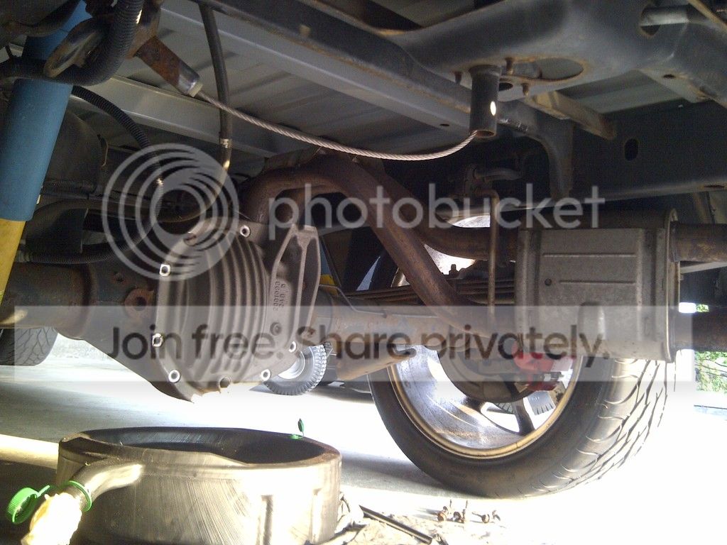

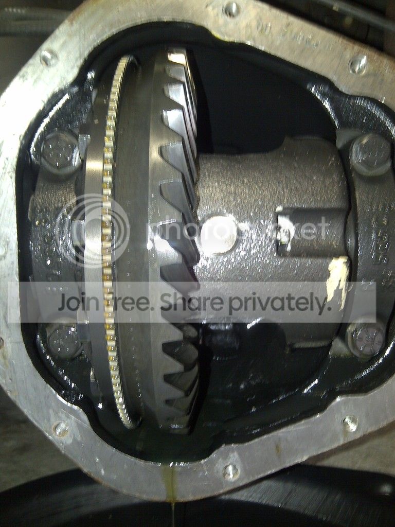

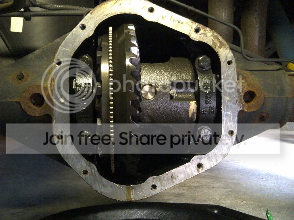

Last month one of the things on my list was to replace my ugly stock rear diff cover with a new Mag-Hytec deeper cover. As I had the cover off I figured I would take some pics of the gears since I haven't really ever looked in there, and wasn't sure if there were any on the forum.
Spare tire removed...first time since I bought the truck, lots of room under there. Actually, it was the first time I ever lowered a spare from a truck. Kinda like how it works, but wouldn't want to do it on the side of the road.

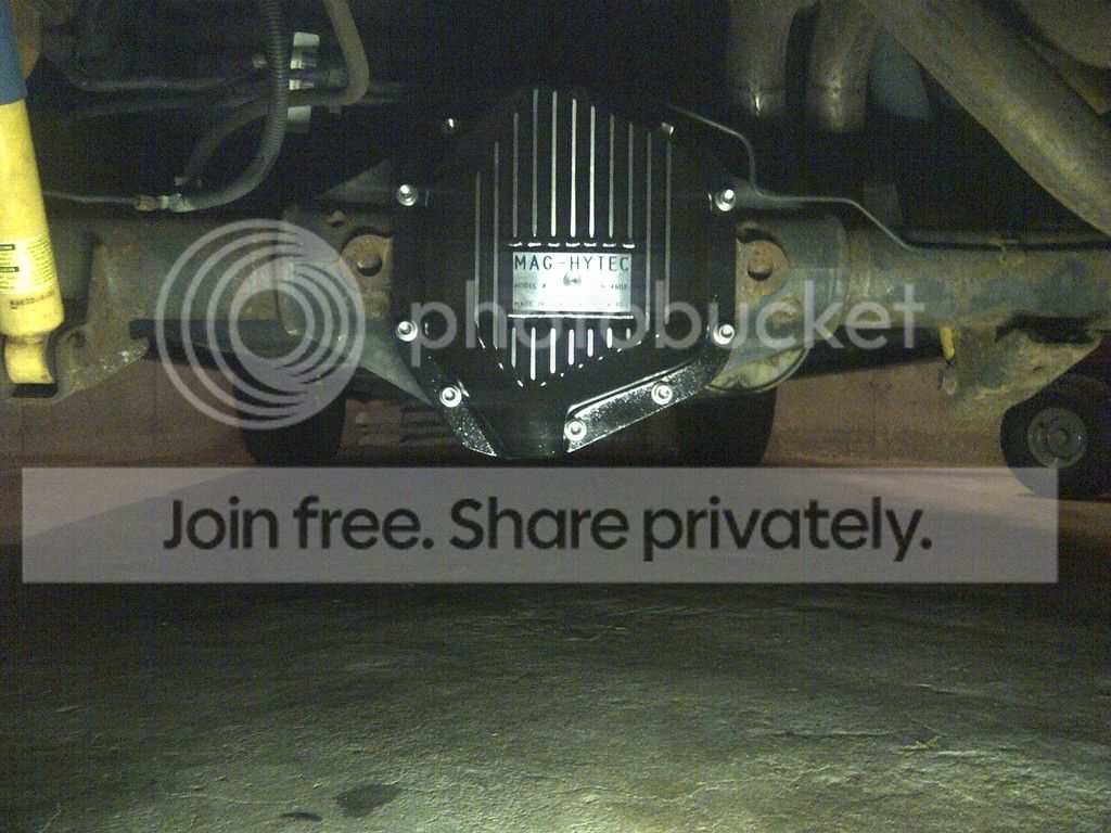

New pan, comes with dipstick and a port to plug in a temp sensor, which I may do just for shits and giggles...
I need to get a few better pics of the new cover installed. It got dark out so I had to use the flash. Yeah yeah, lots of rust, I know. When I install my B&B exhaust, I plan to get rid of all the rust underneath, and paint the axle and whatever else I can so it looks neat.

It is supposed to hold 6qts as opposed to the stock amount of 3qts. Since it is double the amount, I doubled the amount of limited slip additive. I only got to 5qts before it reached the correct level. Maybe after driving it a bit and the oil spreads to the shafts I'll be able to add more(says my brother). I will probably check the level next time I'm at my garage.

Checked them out just now but don't understand how they work? Where are the bearing caps, and how could those bolts attach to them? Looking at my pics I couldn't figure it out.

Ok, I just researched and see the bearing caps are on the sides, with the upper and lower bolts. So do the bolts in their cover just push on those caps, or do you drill into them?
You install the cover just like a stock one. Then turn the two screws in until they rest on the Carrier bearing caps. They usually touch in the center of the cap. Then tighten the locknuts and your done. Except for filling up your oil
