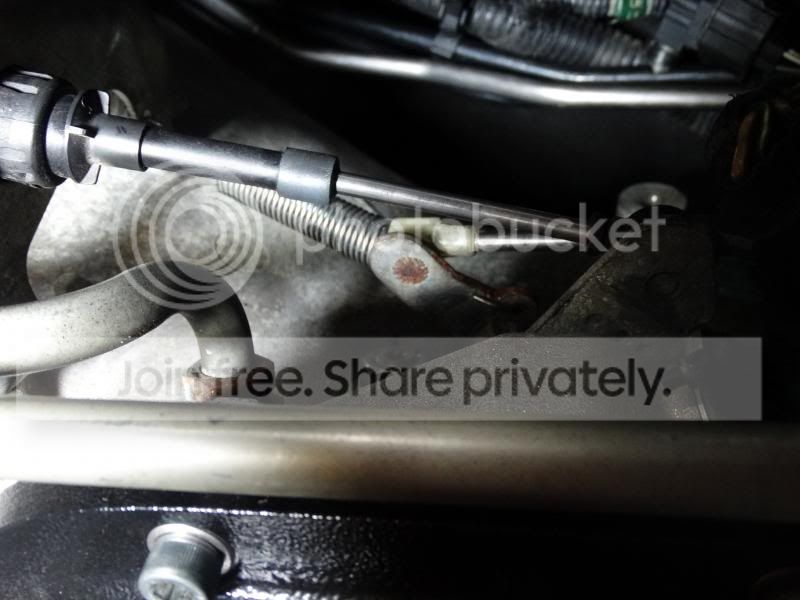

Need help my indictor not showing up in park.I can push the truck about a half a inch and you will hear a click and it will light up.It didn't do this till I replace the neutral safety switch.When it comes back on I can shift it throw all gears works fine till I go back to park.Anyone have any idea what's going on with it?
I did mine a long time ago, I think this is how you correct it.
Under steering wheel, push white clip outward so that its loose.
Make sure gear lever is in park.
Under your truck on the drivers side of the transmission, there is a lever with a spring on it. Make sure its all the way forward (towards front of truck).
Push white clip back in to lock it.
