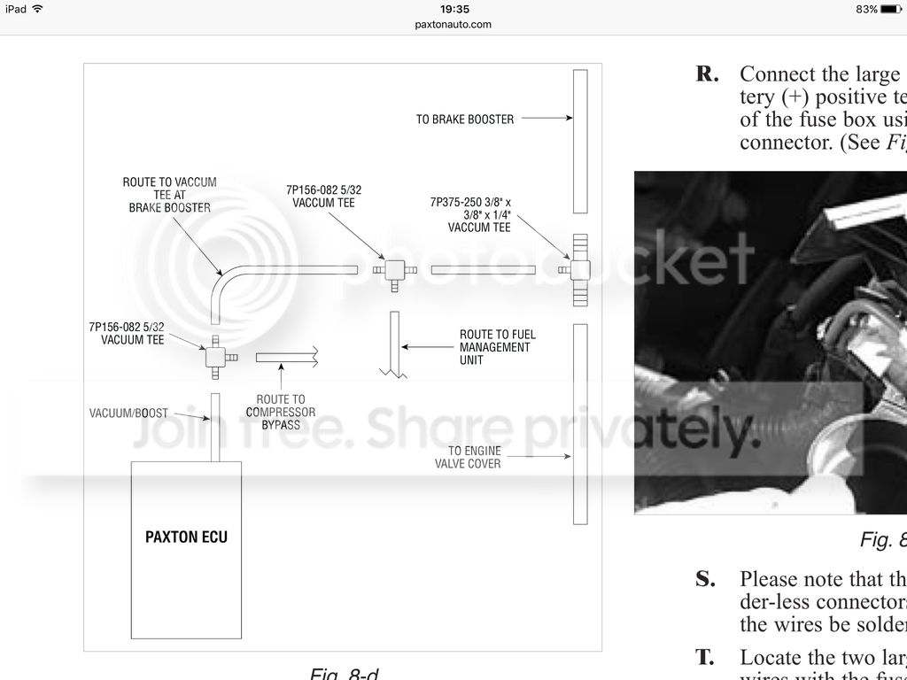

I've pulled the Paxton piggy back ecu out, I just need some help with the boost lines that's ran from the Paxton bov to the Paxton ecu and the ones from the brake master and intake to the Paxton fuel regulator under the truck
What needs to happen to all of these lines?
Is it just a case of blocking/plugging the ecu and the fule management unit pipes?

Pull all of it out. Make it look like stock. Then put a t under the throttle body and run it to the bov
Tee in on the pipe that goes from the valve cover to the super charger?
How is boost mesured with no Paxton ecu? Something to do with the 2bar map sensor?
Get rid of it and go with the sct. The vacuum line that comes off the throttle body. Just looks cleaner because its under everything.
That's what I'm up to. It's all coming out just a bit stuck on these hoses.
Ok so tee the bov valve pipe to the one that runs under the intake manifold to the valve covers? Or is there another one that's tucked up under there?
Remove the tee from the brake booster and connect that back up. Job done?
How is boost mesured with the Sct?

This place is like a zoo. Try not to entertain the animals. Disconnect all the vacuum stuff and re-enable it like stock. You will need a vacuum line to the BOV. you can decide how it goes. The paxton fuel system can be removed as well. and reconnect the fuel rails like stock. the bigger injectors will be controlled by the OEM computer and the vacuum/boost will be controlled by the OEM computer with the 2 bar map sensor. Torrie will sell you a tune that will run perfectly! You upload the tune with your SCT. Before you start it ,turn the key on with the fuel pump fuse in and let it build fuel pressure. wiggle the connections that were tampered with and make sure they are sound. Fuel leaks are BAD! If the connectors didn't click during assembly they will fly apart.
