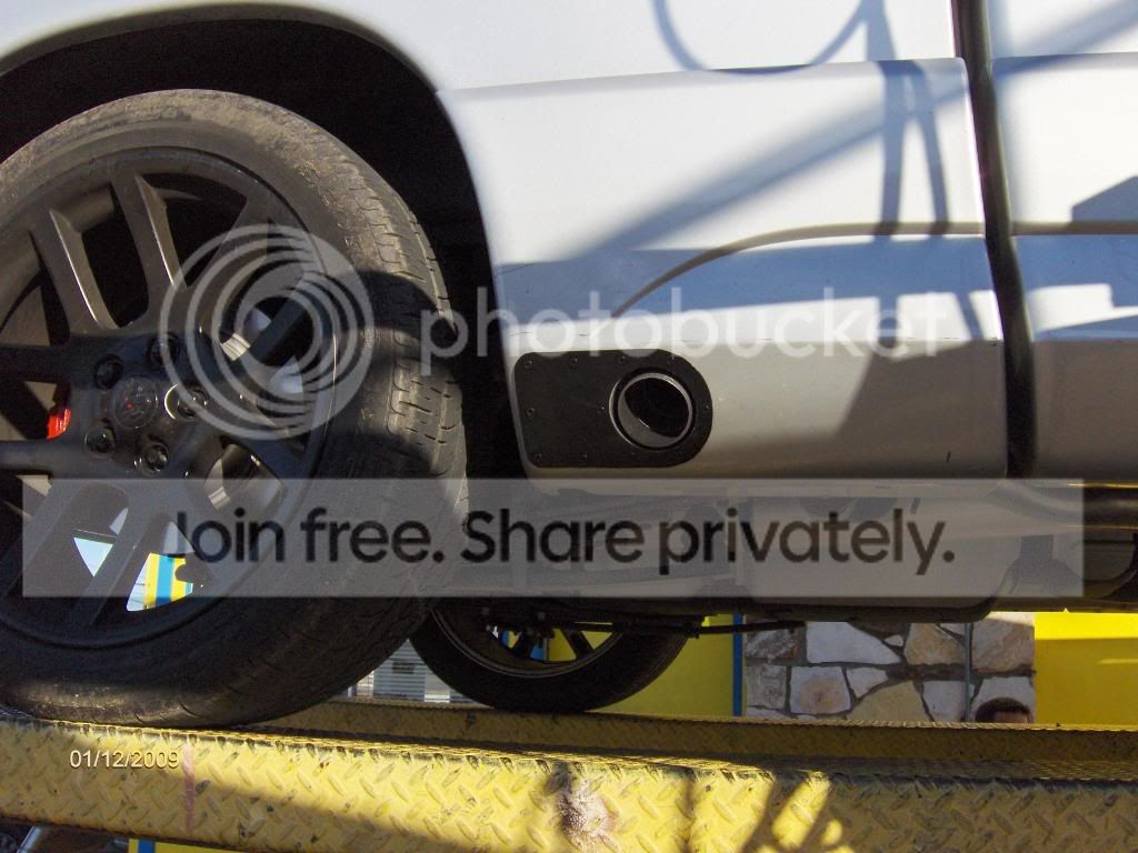

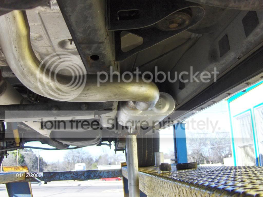

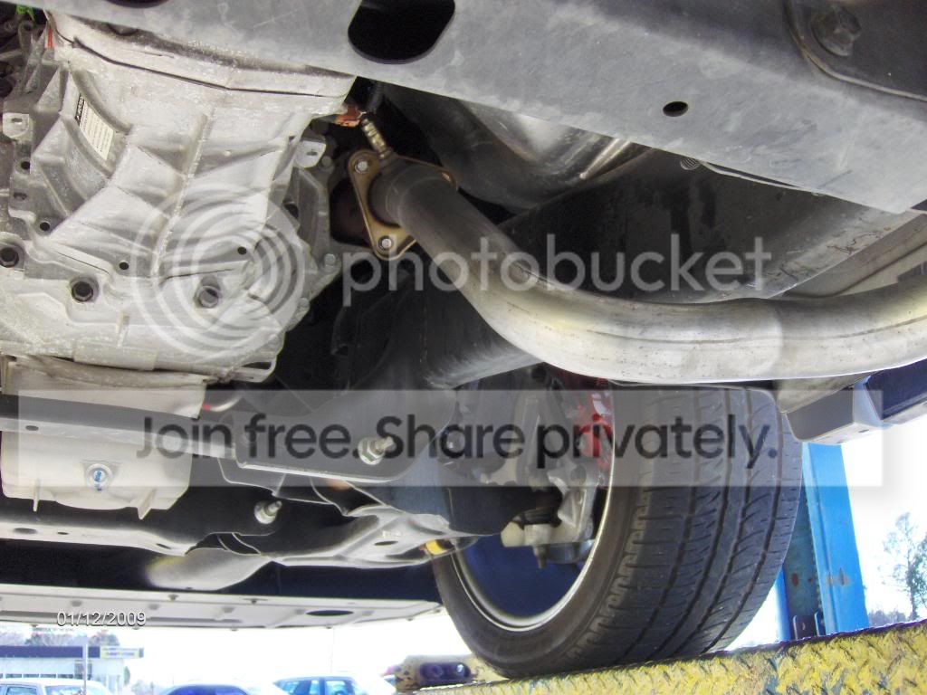

yes I'm out to the agrage to take pictures for you ..... there alot of room under there you just have to make sure that you have enough clearence since our exhaust shakes so much

i took the bumper to a shop and told them to fix the hole on it:D , u need a muffler on each side unless u just doing only one side exhaust.

yes mine is 3" the whole way from the manifolds to the tips.... the tips are a
3" 90º bend but the that points out is flaired to a 3 3/4" tip

Hey bro, the plate you can have someone manufacture, the rear bumper he had used a piece from another bumper I beleive to graft into place. Any good body shop should be able to accomplish this.:rock:
