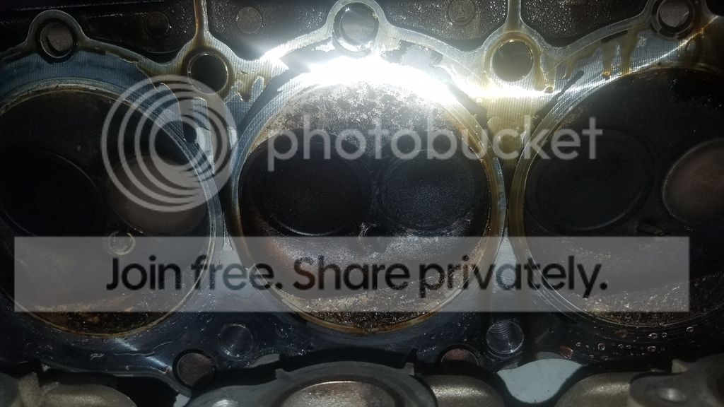

Hello everyone.
I have a sound and I miss a cylinder.
After inspection by camera, the 9 has a valve mark on the piston.
Can the cylinder head be removed without removing the engine?
Thank you for your reply.
Staffie.
yes, the head can be removed without removing the engine.

Hi, it's not easy to access.
This is where I am now.
As soon as I know more I would make a list.
Thank you.

Do you have a picture of the top of the piston?
