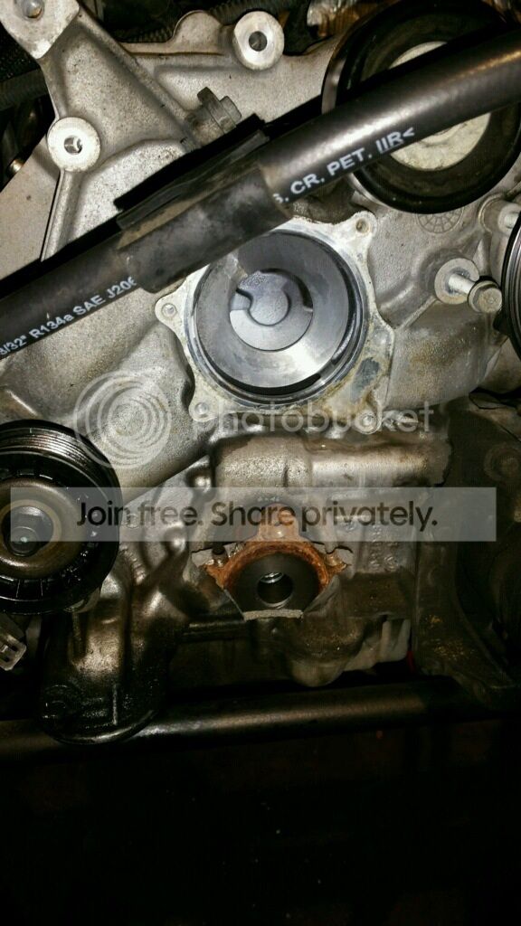

I was in the same boat! Mine came off in 2 pieces and I thank God it was caught before it came off on it's own!
Could always be worse....
This poor guy has no options left. It broke apart during his removal :(
Think he's gonna have to try to weld it together just to try and remove again!
