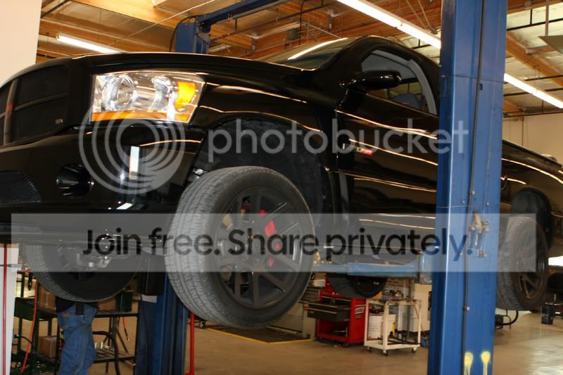

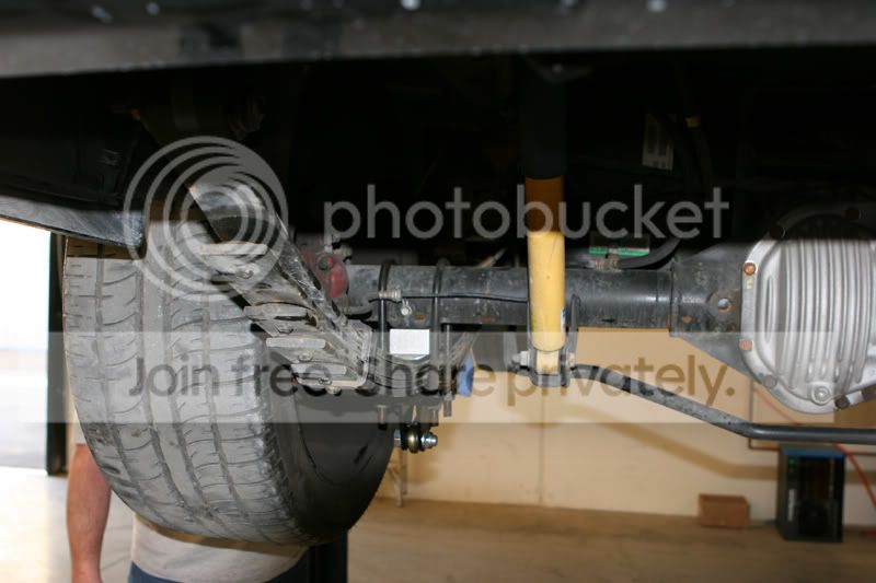

I had the Caltracks installed today at Calvert Racing Suspensions. Talk about a class act over there. The company greets you when you walk in. They offer you a drink and answer all or any questions you have without feeling rushed. They take their time explaining the benefits of the Caltracks and make you feel like your at home.

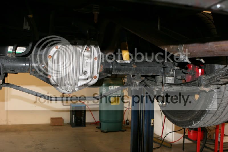

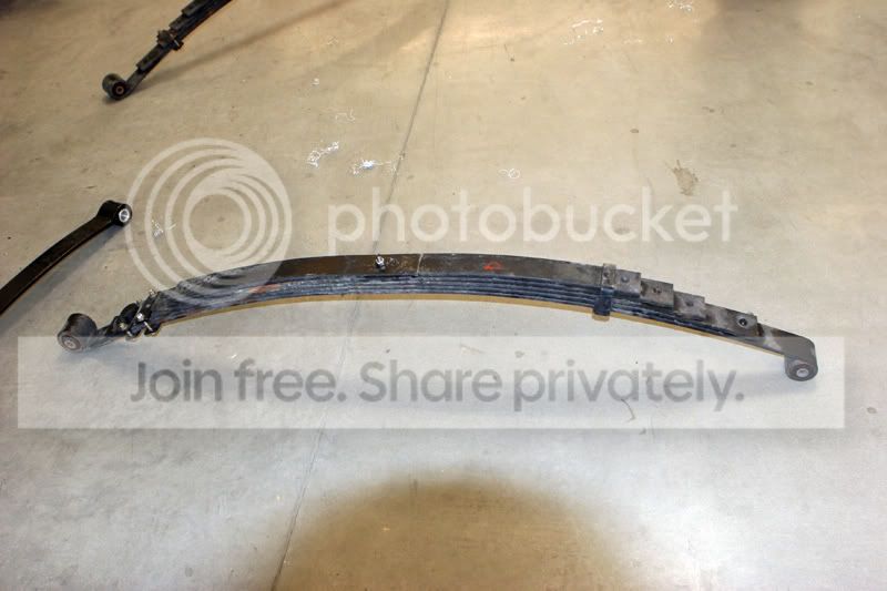

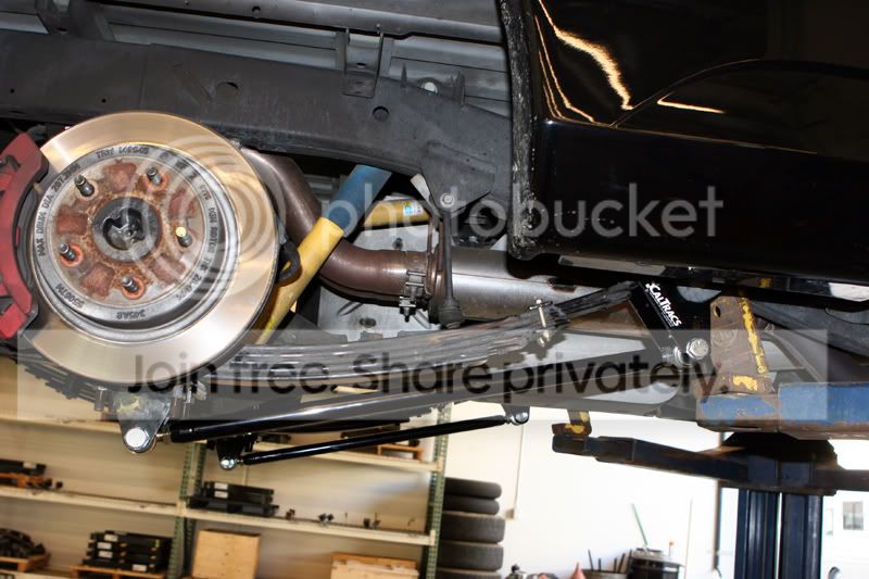

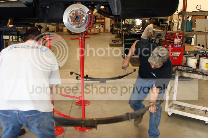

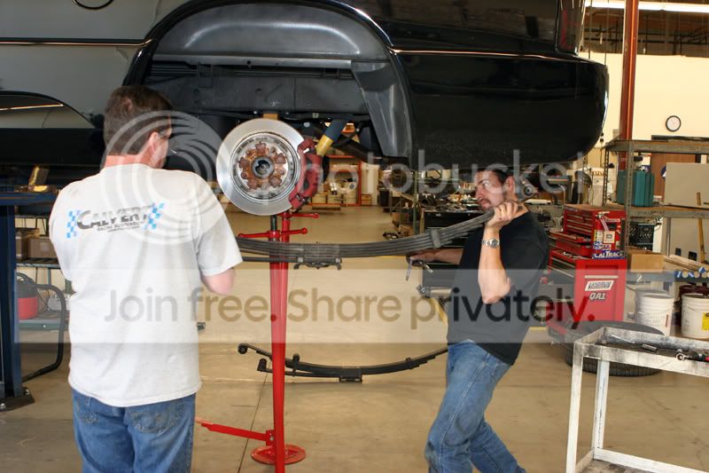

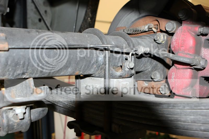

Here are a few pictures of the install:

caltracs help alot but I never noticed a difference until I cranked them down at least 1 full turn. I think that 1/4 turn they say to do is not enough
The only negative I have to report from my Caltracs is the clanking noise going over large bumps. Changing out the front spring bushing for the aluminum one didn't add the harshness I thought it would.
But, the positives are great! It hooks off the line and continues to hook through the 1-2 shift that previously generated a big bark now gets a small chirp and is much smoother.

just a question : on the ground near the springs there's a 1/2 blade as with a aluminium bushing.... for what was that used ? :dontknow:
As with those pretensions of 1/4 to 1 turn... i felt it difficult to decide what is the "just contact" position from were one counts ....i mean how stiff you turn them before you give 1/4 to 1 extra turn.... :dontknow:
:rock: love mine. '05 RC. got a little over 10,000 miles on them. helps on all aspects of drivin. got a bit of a creekin noise & the clunk on the bumps is all. the 1/4 turn is just the startin point for adjustment. got about 1 1/4 turn dailed into mine. makes the ass end look more aggressive & cleaner look.:rock:

Nice Pics....thanks for thinking of us in the process...but they reminded me of how much I hated those cheap bolts on the pumpkin...I hated seeing that rust until I changed to the Sinker Rear End...
That is not part of the srt/10 package. Looks like some other leaf with the aluminum bushing in it.
Barry slide a business card in between, then turn the bar until it makes contact and you can still pull the card out. That would be your starting point.
