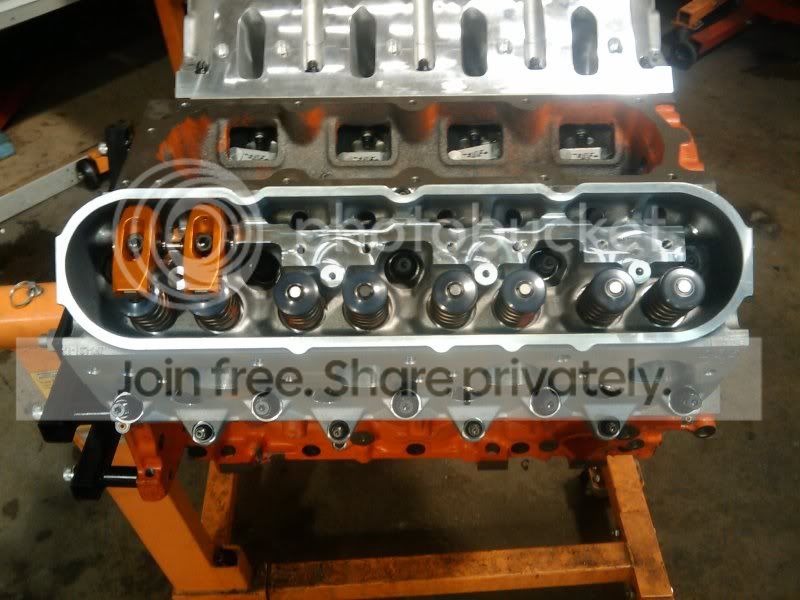

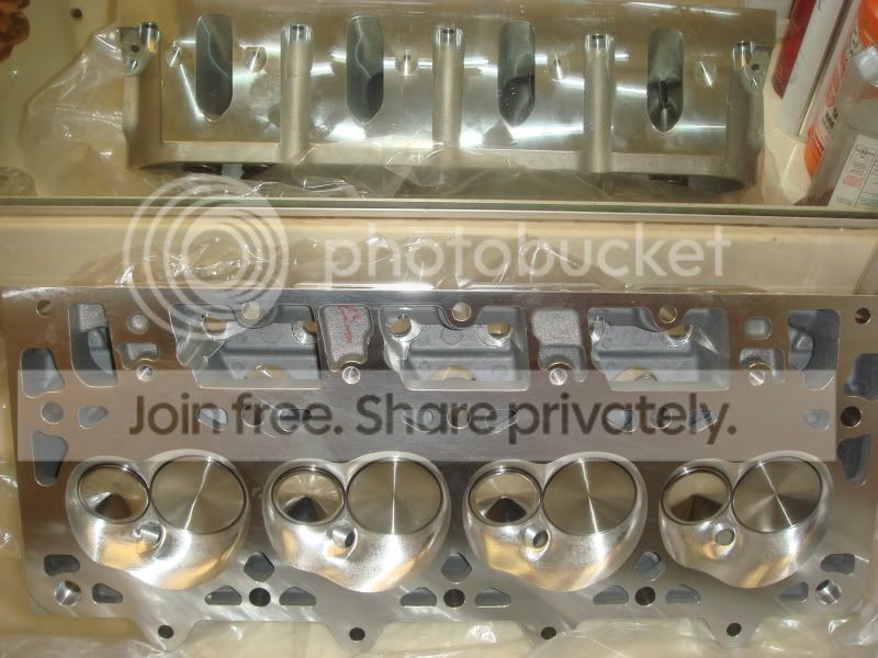

lsx gmpp block (head bolts will be 1/2 inch with the 6 bolt heads)

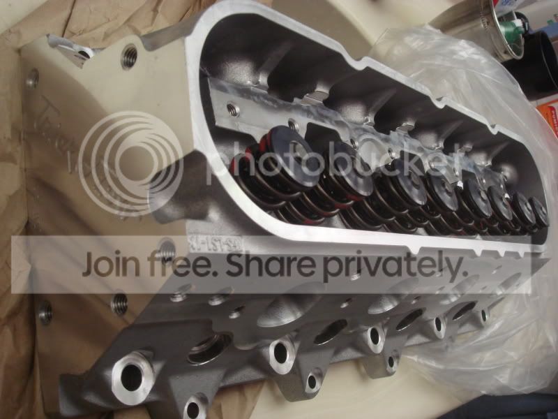

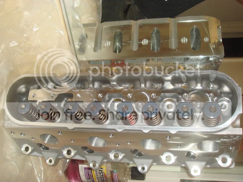

trickflow 235 cc 6 bolt heads with inconel exhaust valves and .650 lift springs

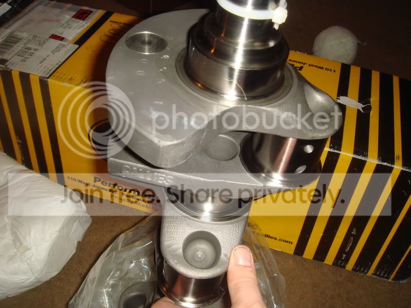

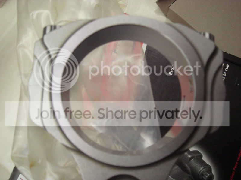

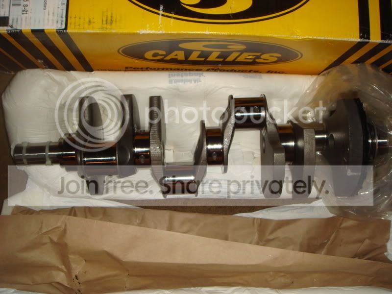

callies 4.00 x 6.125 rod 2.100 journal dragonslayer crank

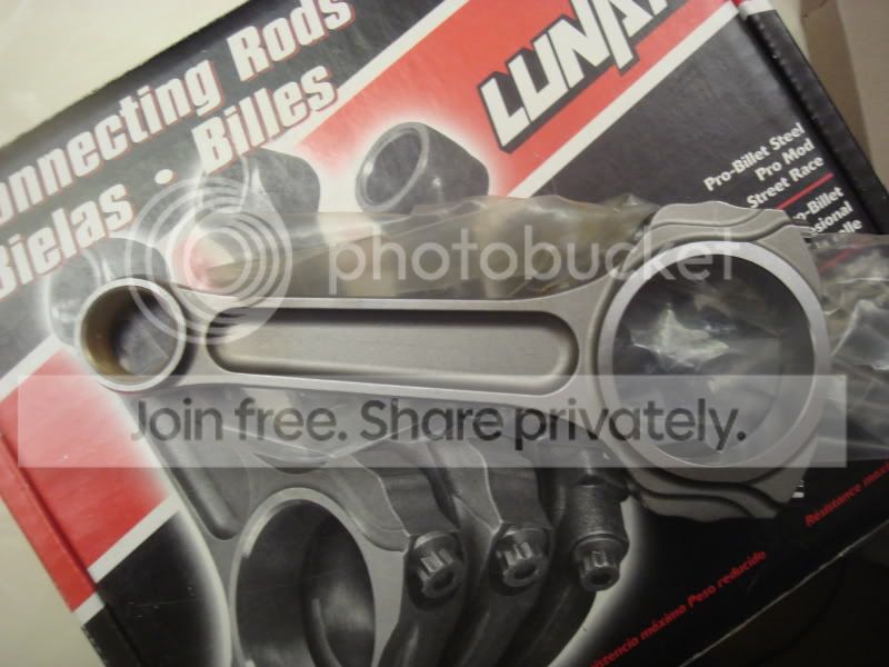

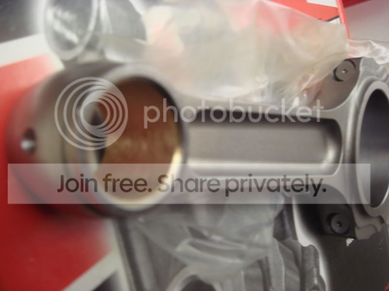

lunati pro billet 6.125 i beam connecting rods w 225,000 psi bolts

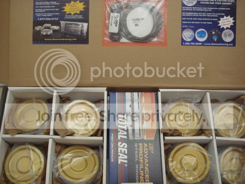

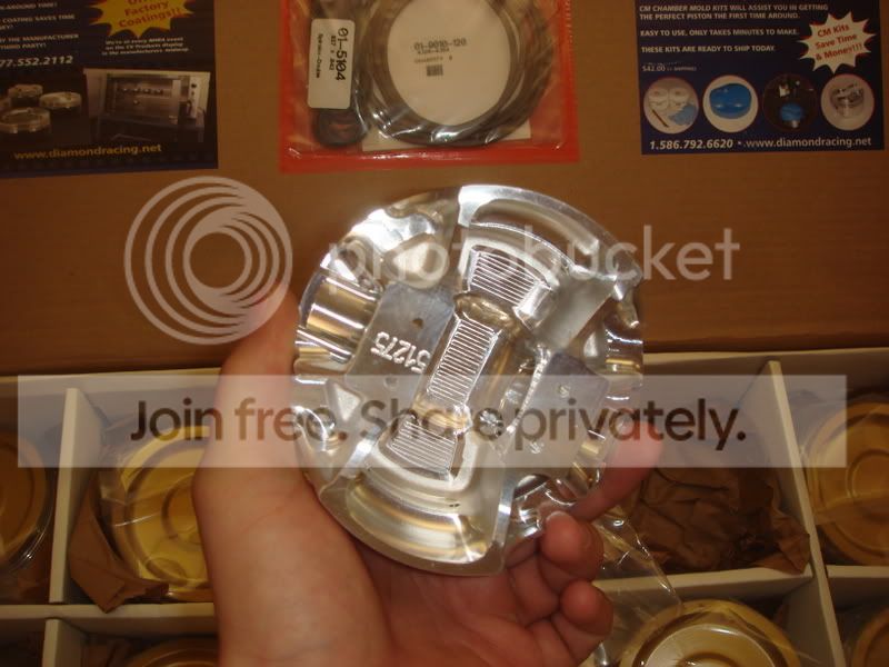

diamond 4.125 custom coated pistons
morel ls1 hydraulic lifters
yella terra ultralite rockers
asp damper

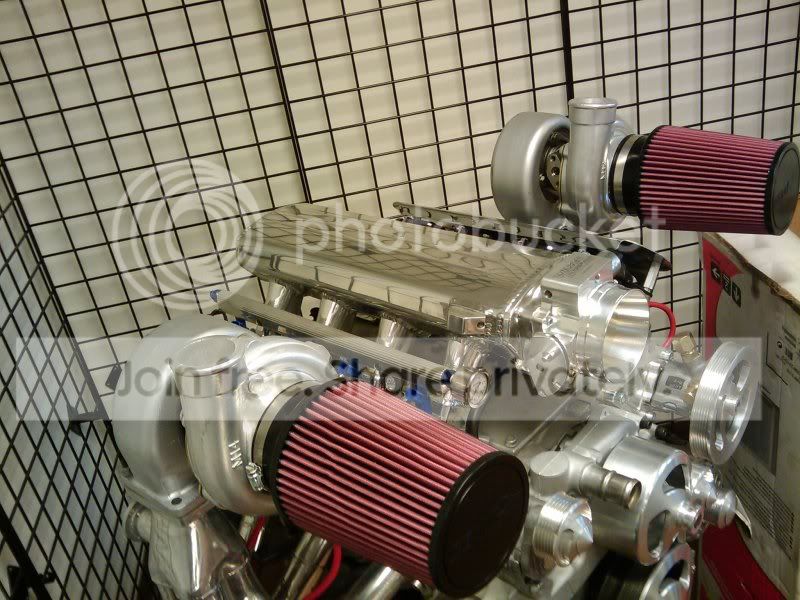

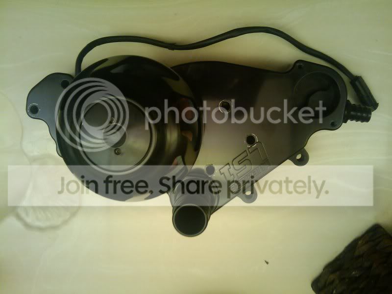

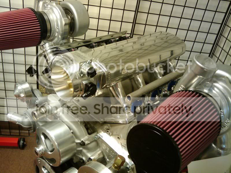

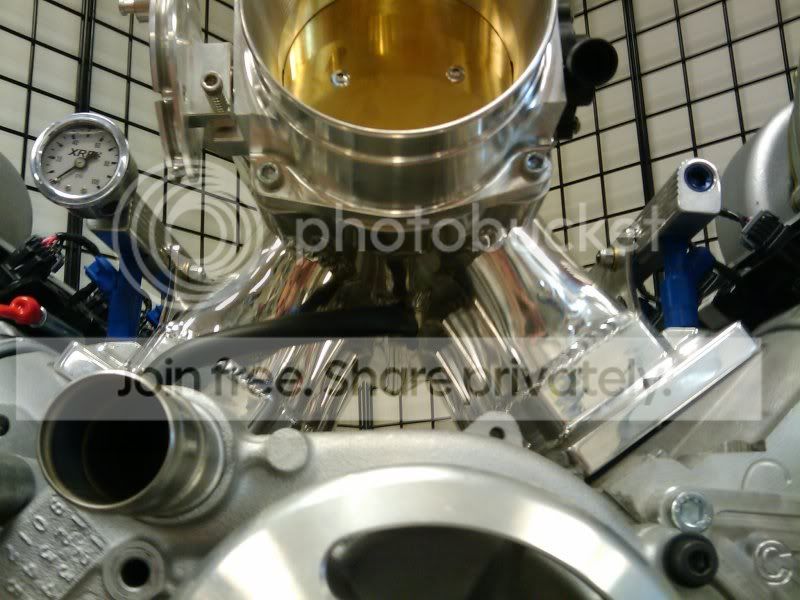

not my turbos but somthing else there will be used

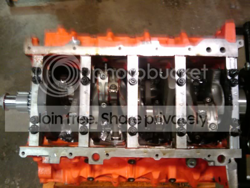

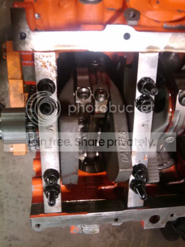

shows the callies dragonslayer, lunati pro billets

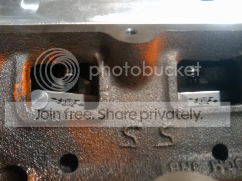

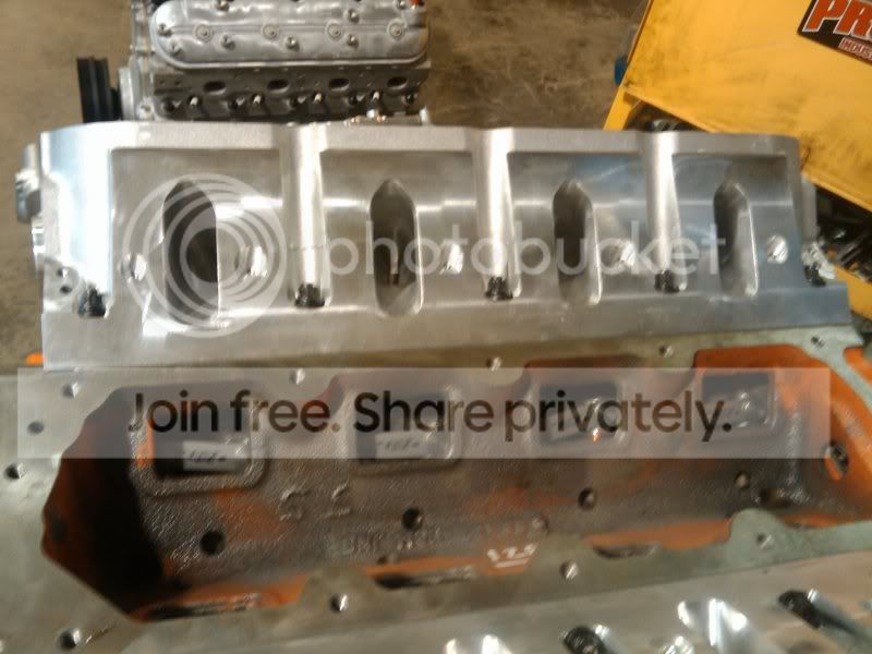

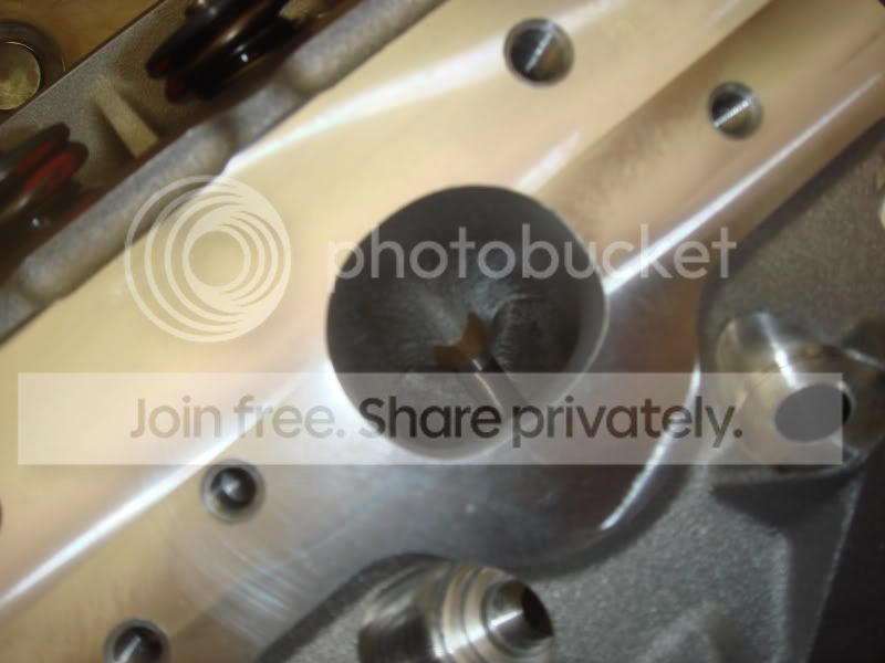

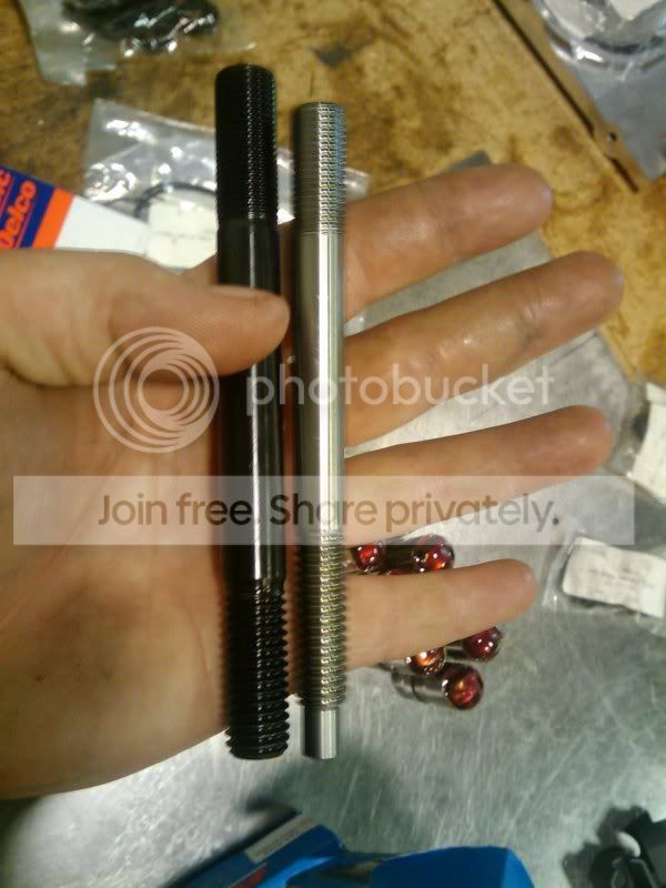

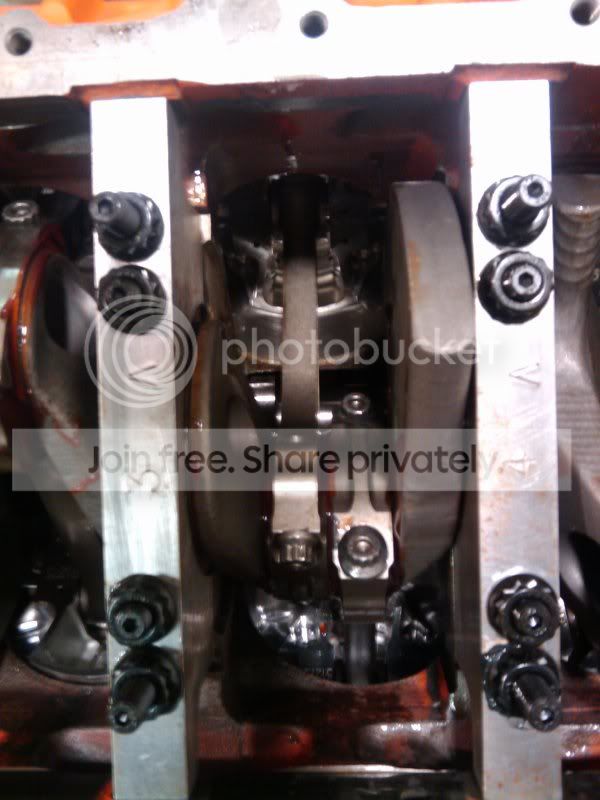

here is a lsx head stud vs a bbc stud which is what we are using plus the extra 2 bolts per cylinder
you can see the extra bolt on the heads in the lifter window.
waiting on mounts from hs for the rest of the rockers.

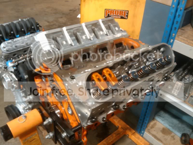

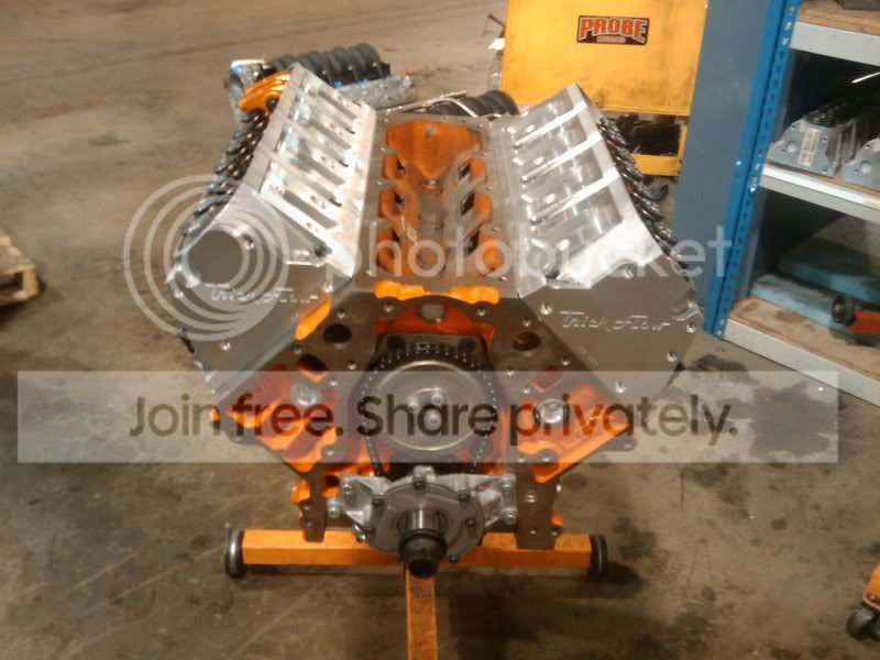

and its home ready to rock ,
just pulled the old 370 motor that lost a head gasket.
alot more progress to go but this motor took almost 6 months to piece together. just got to get it in running and then to synergy who is making me a one off twin turbo setup using gt35's or maybe a lil bigger. plan is 1000+ awhp and 10's all day on pump gas with meth

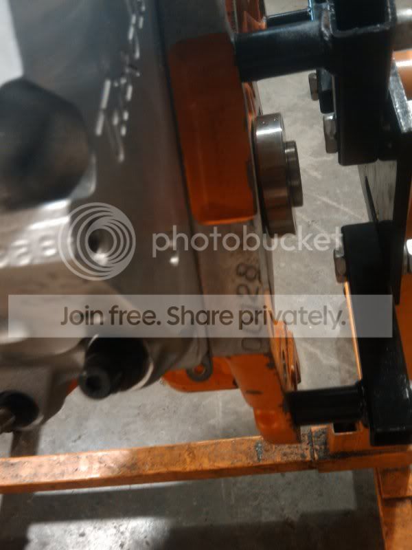

for the block ? someone local did most of it, cbm motors did the motor . the owner is a good friend of mine and he had to send it to san diego for some of the machine work like bore and tapping the block since they are some dam dense.
