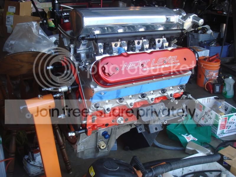

JMB Justin said:Very Nice! No expense spared on that project for sure. T4 35R's would be a nice setup for 1100-1200whp max, you can also run a t04Z or PT67's, both should be good for 1300whp+.
6pakattack said:I love that friggin Intake Manifold,gawd that is gorgeous !!!!!!!!Is that Hemi Orange I see the block painted with ??:rock: :rock: :rock: :rock: :rock:

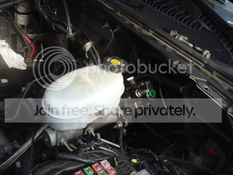

ran into a little problem , the way i have the regulator wont work as it hits the firewall so im going to bend some hardline up and make my own fittings on the rear passenger rail to push the regulator back a little . also going to have to cut the driver side fuel rail down to near the injector and cut a -8 an fitting and weld it to the rail . then use a 90 -8 female to hose then to the y. this is with the stock 105 amp alt , going to pick mine up tomorrow and make sure it will have a shot as its even bigger but should work . below you can see my issue with the smaller alt.
basically just have to , install alt headers, plum the fuel , i made all new battery cables that are ready to install. plum the wiring, new knock sensor/cam sensor harness. electric water pump . finish the hydroboost which should be cake. and all the little b/s . hope to have it fired by this weekend if im lucky .
blwn SSS said:nah no hemi orange, gm orange though . thats how these blocks come from the dealer.
