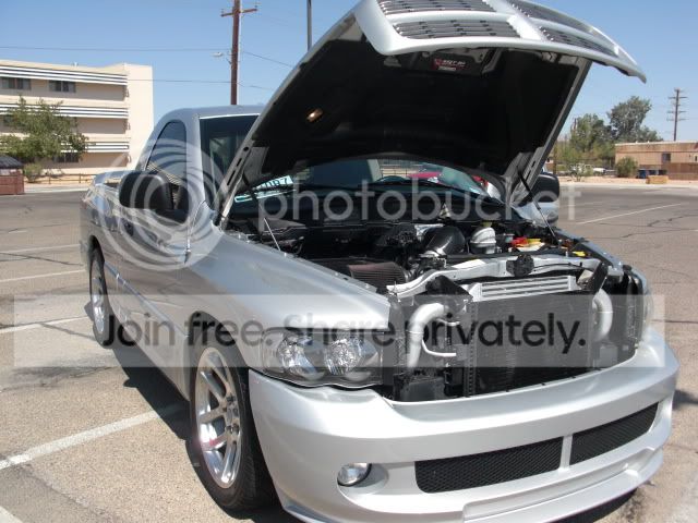

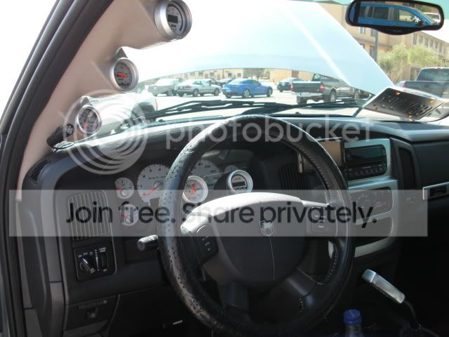

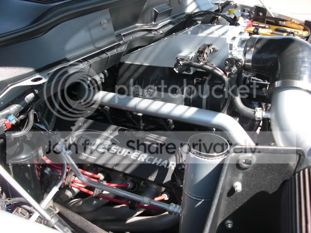

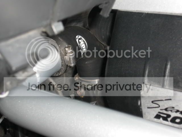

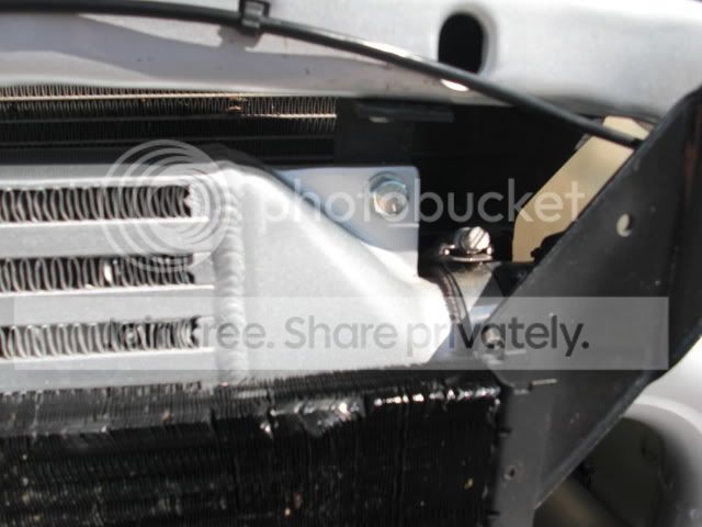

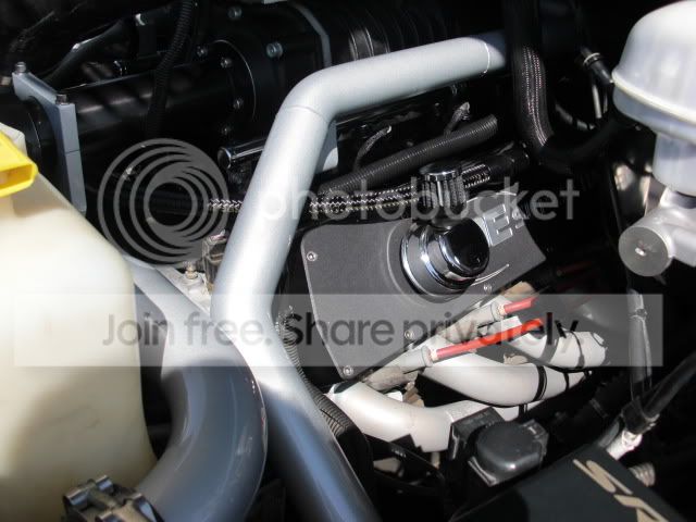

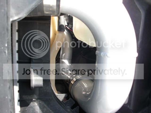

The Roe got a makeover... top is now silver, bottom is black to match the valve covers. The cooler also got painted silver, as well as the front bumper... some paint was peeling off:(. Had a breather system, oil cooler lines, Dpic and fuel pressure gauges from Stinker installed.
It's only making 7lbs of boost with the 10# pulley:dontknow::confused: for 635rwhp. I think I'm going to get that lower pulley from Tony, and see what she does. Anybody got any ideas on why it's not making more boost???
I'll clean it up some more, and get some better pics tomorrow. I have a few more little mods to install too. I've been wanting to do this for a long time, so I was excited and had to snap some pics:D

Your HP is good if it is only boosting 7 LBs....I have Stinker's 7" crank pulley and I get 11 LBs with Roe's standard 5.6LB pulley.
See you have a fuel pressure guage...what does your pressure read at 5500 rpm...

My fuel pressure stays right around 62psi no matter what RPM I'm at. Kinda has me wondering if it's functioning properly or not. Shouldn't it fluctuate a bit??

2 3/4 is right for 10LBs....check the hose connections on the rear of the SC where your guage hooks end...you may have a loose line though my guage always stayed at zero when the line came loose....but you might also have a hole in the lines........you could also go by your dealer or other auto mech and see if they have a shop vacuum/boost guage to check against yours..
