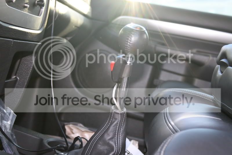

Line lock

Also a couple of phone pics of the Nos activation, heater and purge....Also installed a line lock safety switch :D
