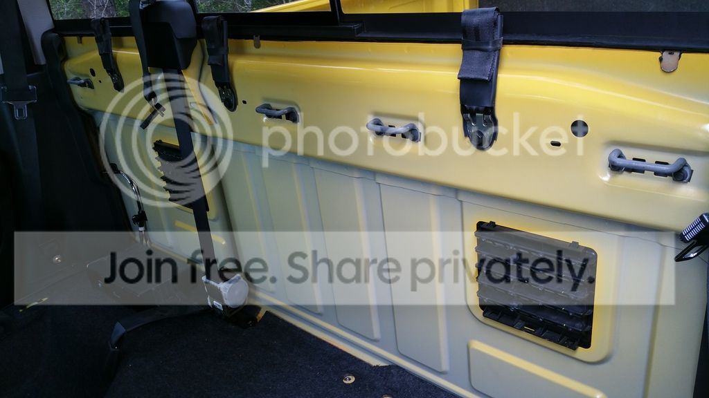

This is what is should look like:

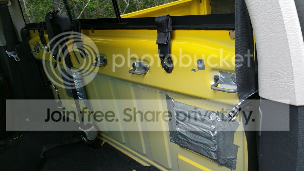

Now flip the four brackets around and optionally tape the holes to make it look like this:
