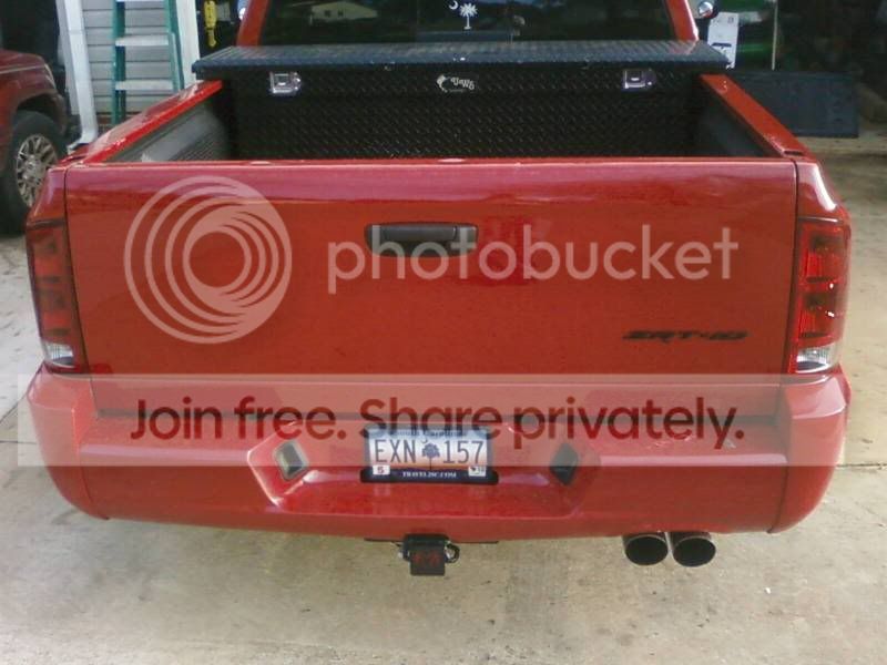

I got the standard OEM kit direct from Dodge...if I recall it was about $120 and was complete. Piece of cake to install though figuring out the rear side panels are attached using slide clips took a few minutes to figure out.

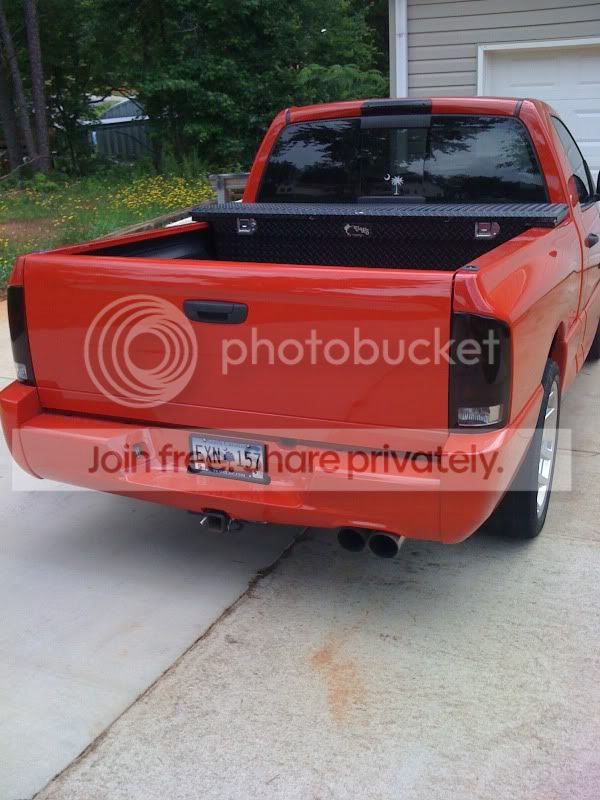

Curious, how did your install go? I just got the accessory hitch and put it on and have the bulge in my bumper cover. Not too happy. Did yours do this too, or did I possibly get the wrong one?
Looks like I will be ordering one of the hidden hitch ones.
