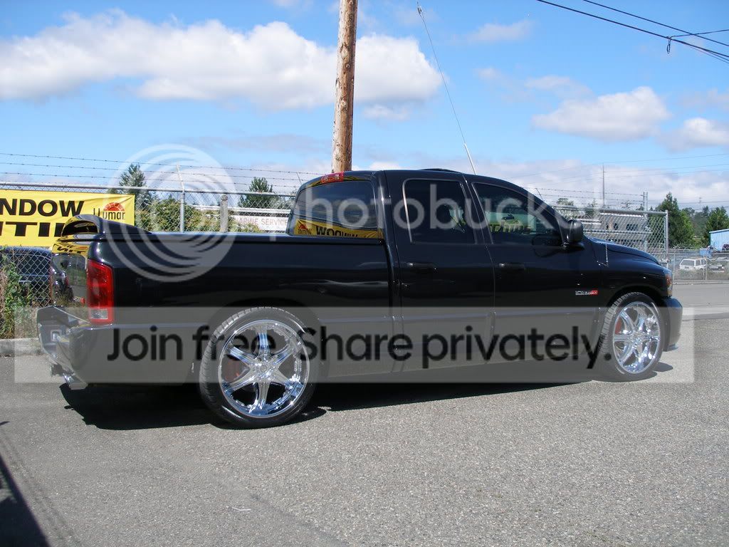

take a good look at my butt:
that's what a spring flip and shackles do to your rear when you have 200kg to carry all the time (LPG tank) . Result : only 2 1/2" suspension movement left.
