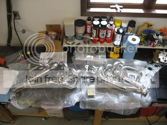

My headers are in route to my house right now. If UPS had live GPS on their trucks, I'd be chasing his truck around town right now. The suspense it killing me. Install pics to come...

They just showed up. I tend to be meticulous when putting stuff together, so I am sure it will 2-3 hours for me.
The fasteners that come with the headers are crap. I am surprised for the amount of money you pay for the headers. You think they would at least come with ARP, not a grade 5 hardware store bolt. I have a set of Stage 8 that I will be installing mine with.

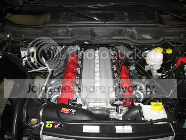

The headers are on!!! The recycled stock gaskets are holding. It isn't rolling yet, but I started it up without the fender liners and wheels on so I could check for leaks. So far so good.
A few observations:
-You almost have to have the Stage 8 bolts. The bolt heads are smaller, so it is easier to get a wrench on them vs. the bolt that come with the headers.
-An 11mm swivel socket is my friend :)
-The collector bolts I had been using were actually too long. I had to get shorter ones.
-Stick header gaskets to header not head when putting them on. The copper sealer is tacky enough to allow the gasket to adhere to the header. Much easier than sticking it to the head.
-Lay towel over frame and control arms to protect the header finish while installing them.
Here are some pics:
I was getting tired, so the rest will be finished tomorrow.

Killer bro! nice install:rock:
