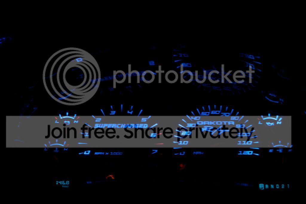

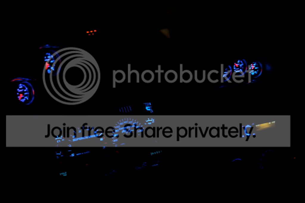

I changed the color in my Dakota from green to blue. Got all the bulbs from RadioShack. The cluster will have to be taken all the way apart I'm sure bk that is what I had to do in the kato. I all so changed the A/C and light switch lights to blue also. The cluster bulbs are just a twist out bulb but the others I had to solder in. I have been thinking about doing it the srt-10. I will look and see if I have some bulbs left over and post the part numbers might be the same, but it will give you an idea. The only lights I couldn't change was the gear selector and the mileage.

Changing them red would be pretty hard/impossible. You can see it in the above pics of the AC controls, the red dosent show through. Green to Blue swap is easy because the light wavelengths are similar.. a green to red shift are on near opposite sides of the spectrum.
Looks sick, regular bulbs or led?
I got the push to lock bulbs from superbrightleds.com for the dash lights. Don't recall what the part number was. I have been trying to find it bk I'm thinking it will be the same. I'm still looking, but here is the link.
NeoWedge series LED Lamp Specifications
Will post some info on the head light and A/C controls this afternoon.
