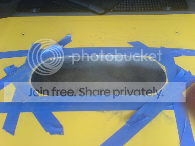

i think that will hurt more than help ,,,those long ass metal tubes will be the same temps of your motor in a heartbeat after you start motor let alone do a burn out sit on line waiting to go ,, yada yada yada,,you will be sucking hot air till your halfway down the track never looked at a bee hood ,,is that hoodscoop fungtional or fake ??if you have a hole in hood slap a small cone filter on T.B and let it suck air through scoop
Try to keep to the old rule of "KISS" when doing something like this !
couple things that maybe would help, jsut advice there farmboy
one take and set up the cold air like y ou got it, run down the road and take some iat readings, then like ironhead says, fab something outta anything , heck carboard, off the scoop into the air filter right at the tb, take some more readings, but move it around a bit , and get some readings, he is correct , the engine heat will heat up those tubes pretty quick
next i would move the nos nozzle to more of a centralized locatation, where its at is not "bad" but more centralized like in the boot itself where the air converges will be more of an equal shot
