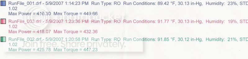

Ok so i went again to the dyno but i was very mad about the service in the shop i went to they made me wait like 1 hour and they had no one on the dyno and thet were not doing jack shit in the shop and when the got me on the dyno everything was in a rush they didn't even put any blowers or fans infront of my truck im so pissed i feel i got really low numbers, these were the results.
#'s arent too bad reguardless....

Your air/fuel ratio (a/f) is WAY rich. Its better to be rich then lean but thats well into the way too rich side. An ideal a/f ratio is 12.0
You could present your dyno graphs to DC Performance so they could in turn adjust your a/f readings (give them a current list of your mods) and optimize your performance (lots of power and torque look to be available) through a custom program (computer).
Since your in Florida you could call Roe or Doug Levin and ask them what they may be able to do for you.
You could also go with a CAI , catback and and headers and mids and that should lean you out :dontknow:

The bottom graph gives you the A/F mix.
