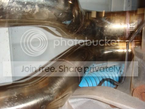

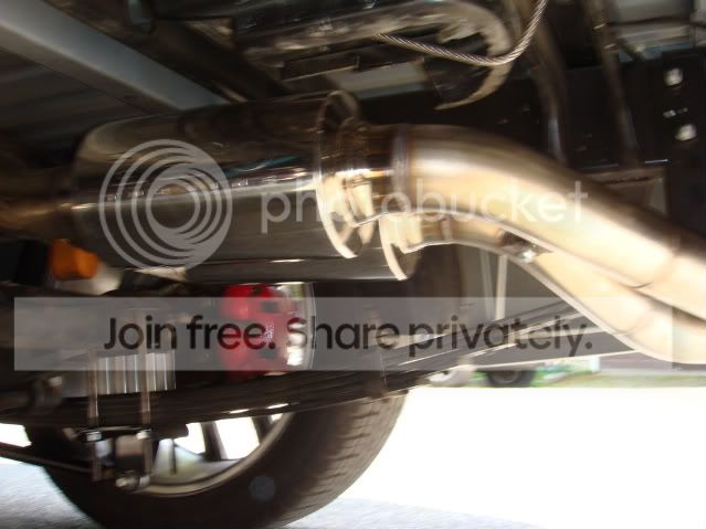

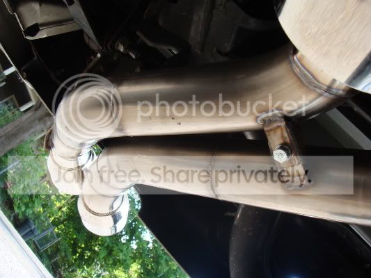

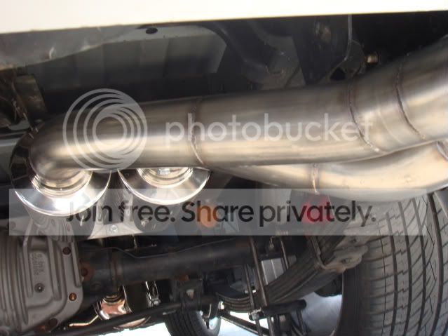

Installed two Aeroturbine Resonators in rear. They really take the edge off of the sound. Thanks Barry for your ideas and thanks to Dan at Pruven Performance for an A-1 job! We used two smaller ones resulting in less radical bends than Barrys'. Exhaust is 3" BB Mandrel bent fron to rear:D

yes, you're right... your bends are smoother :D ..i had no choice , i took the smallest for that diameter they had on the shelf... ;)

Its a complete BB manifold back exhaust system. We removed the straight tailpipe which was the source of the resonance and replaced it with these parts.Its souns more like a tamed animal:D Ill try and get a sound clip:D
