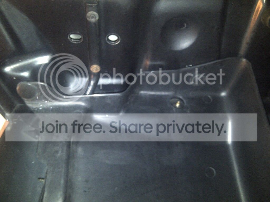

Dont mean to change the subject but by the look of your pic are those the air deflectors behind the grille ? if so can you tell me if they are attached to the grille ? i have mine that were given to me loose but couldnt see how they attached to the radiator support
Hey 572mopar, here are a couple pics of the attachment. The pics are looking from in the engine bay up at the grill. There are two screws that attach the bottom to the grill support, and (3) plastic rivets for the top. Hope this helps!
Awesome thnx, it seems to me having these would be good for aerodynamics, iv had my deflectors for 3 months not able to figure out how the heck they went on
