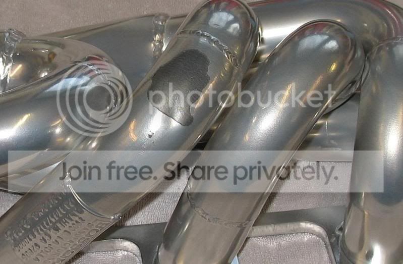

I have had my Bassani's on for exactly one week now. I popped the hood today to put in my new grille and noticed a roughly 2" x 2" area on the driver side header where the ceramic coating is missing (I'll see if I can get some pics up later). It was there when I put them on. It looks as though it flaked off. I can feel a definite ridge between where the coating is and where it is missing.
This really bums me out since I spent close to $1k for a set of headers and now the coating has flaked off. Anyone deal with Bassani's warranty before? The coating is warranted for as long as I own the truck against "defects".
High temperature ceramic coating on Automotive headers is warranted against de-bonding and tube "rust through" for as long as the original purchaser shall own the vehicle on which it was originally installed; superficial surface rusting of header coating, especially between tubes, is considered normal and therefore not warranted as a defect in materials and workmanship.
Would you guys consider this de-bonding? I plan on contacting them on Monday to see what they will do.

Mine are new.... and have done this too. It looks like where two pipes cross, the added heat right near the flange causes the header coating to look powdery. I'll post a pic soon. It doesn't look nice.
I spoke with Bassani today about the warranty. They stated the coating is warranted for the life of the vehicle and it would be covered. However, it will be close to a month before I get it back. I have to pull the header off tonight, box it up, and ship it to them tomorrow. Once they have it, they send it out to get recoated, which takes about 10 days. Then they will ship it back. They only cover ground unless I want to pay extra. To sum things up, 3days there, 10 days to get coated, and 3-4 days back. That is roughly three weeks at the minimum my truck will be down :( .

I already got it shipped off this morning. I am hoping that being nice about it will get it through a little quicker. Here is a pick of the area:
