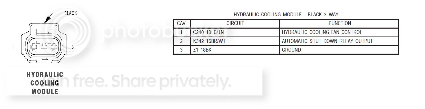

Belt came off and took pigtail from the hydraulic fan solenoid I have three wires and was wondering I I could get a pic that shows what color wire goes where so I can make a pig tail, there is a black , brown/white, and green and yellow,. Thanks in advance
Might be too late by here you go.
[/URL]
Awesome thanks man your the best.! I've had my truck down since April 27th finally rebuilt engine in December, then hydraulic clutch issue( I needed a 7/8 clutch master) then this happen . yesterday the first day to drive it when its 100% ready ,got a ticket ,what a trip this truck has put me through. Thanks again

1999 ford alternator 3 wire pigtail fits our fan solenoid if anybody else looses there's like I did.. yeah being this is the first motor rebuild I've done.ive rebuilt some 48re but this motor was a lot easier than what I taught.
