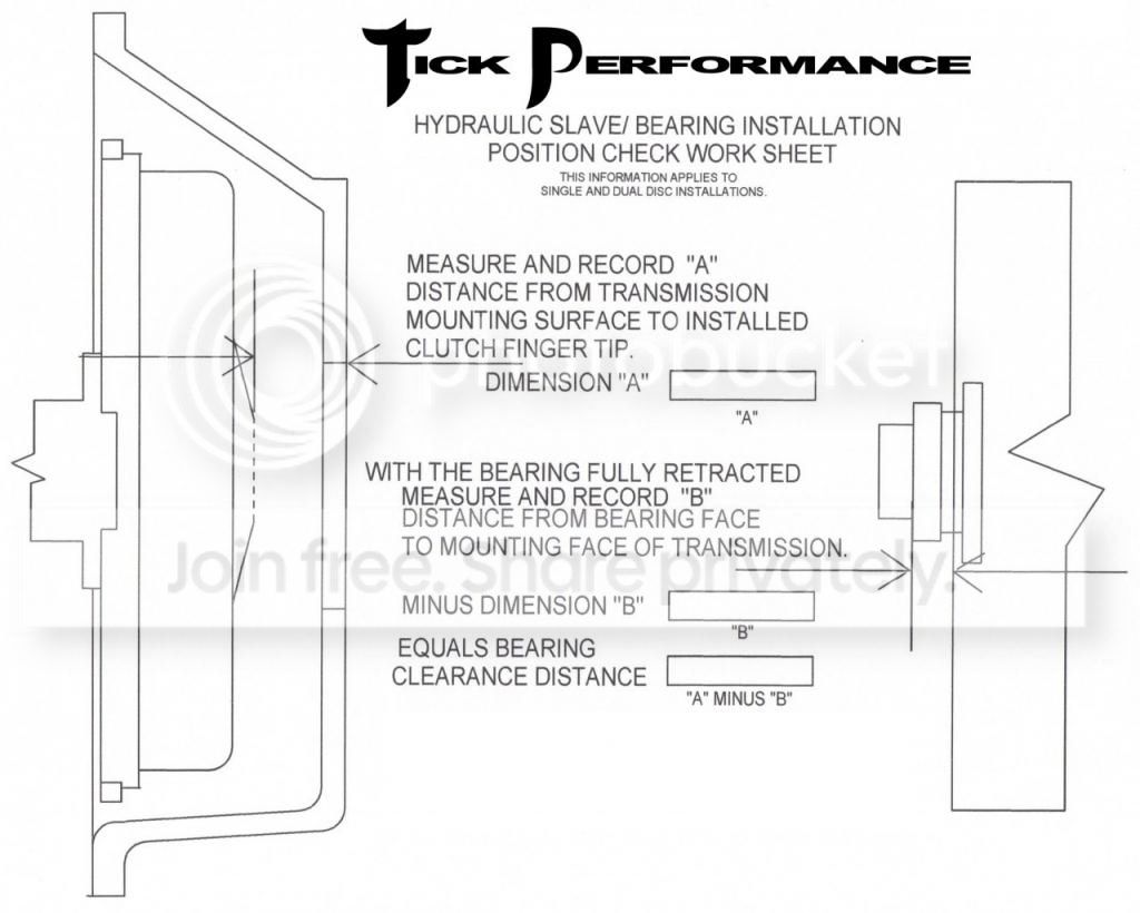

Here is what your shop needs to do to determine which shim to use:
What VPRPWRD said is 100% correct.
Have them measure but likely it'll need the shim or will never fully disengage. No high speed shifting, and notchiness during normal shifting.
