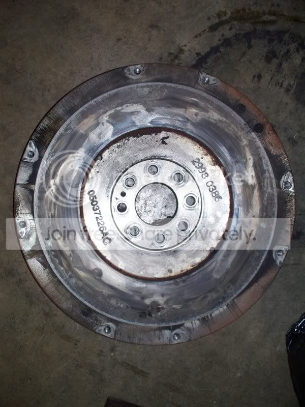

I dont remember my stock clutch having to be near the top before engaging....but the trans never shifted well with it..This is my flywheel after 6,000 miles...the clutch was almost in the rivets.....CF (and new flywheel) shifts 1,000% better..
Sorry to hi-jack but which flywheel did you go with with the CF, do you get any noise from the tranny with it?
I have the Fidanza............there was a little chatter during the break in when pulling into my very tight garage but otherwise no noise. You can just buy a new stocker flywheel and mate that up with the CF clutch, but you gotta have the viper master slave for the CF to work. Stock setup is not strong enough for the CF to work properly.
