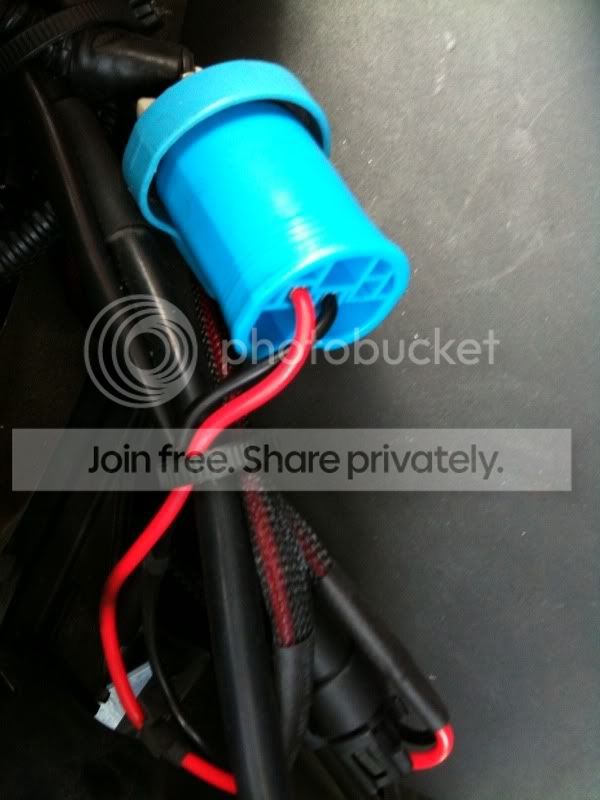

I'll take a pic of my set-up so you can see how it looks
Your ballast prob looks similar to this...and the wire on the right side is of the resistor
This is the connection to the headlight and halfway down the line you will notice the connection where the factory plug meets to the resistor
That's the same exact set up I got Kickin :D Love em and they work great and look even better :D
