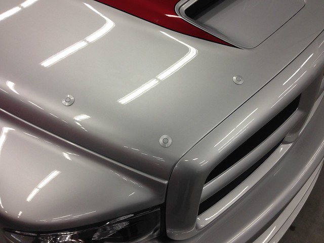

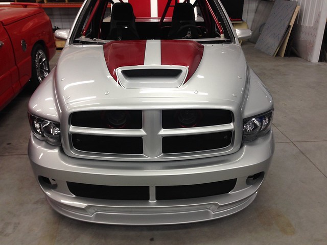

Use the cross brace on each side of the radiator. Measure 3 times, so you only drill once. Feed the lanyards down thru the grille.
No stock latch, 6 work at 180+
