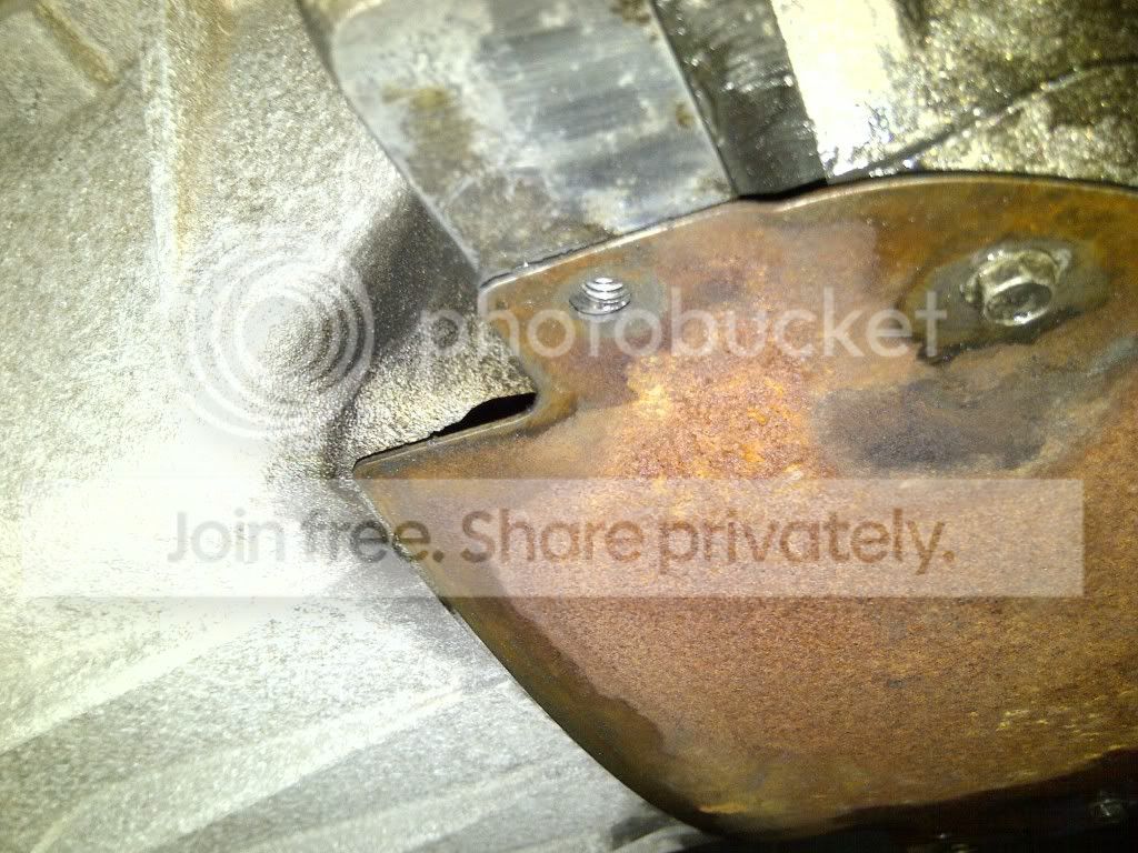

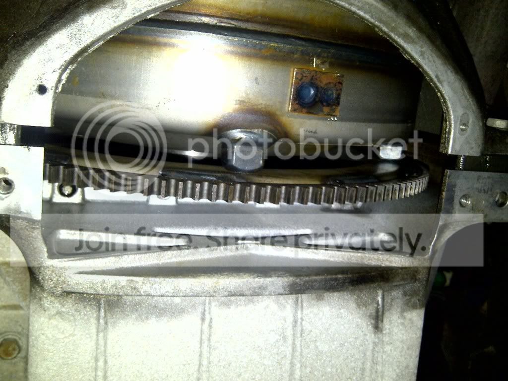

    So I bought a 2004 srt-10 a few months back it only has 44,000 miles on it. I was getting ready to change the transmission oil when I noticed something that made my heart stop... I'm no mechanical genius but this just didn't look right to me... I don't quite know how to explain it since I'm new to the srt-10 but I'll attach pictures. I tried to include the engine oil drain plug in the pictures for reference on where this is located.

    So all that's wrong is a seal? Because it looks like there is a hole in my transmission...

    That's just a sheet metal dust/inspection cover.

    I'm freaking out about the gap... If you look in the gap you can see a gear. I figured that's where the oil came from I wasn't worried about all the oil as much as that gap. I thought there was a crack in my transmission or something

    arrestme is right, thats just the inspection cover for the flywheel, the teeth you see are for the starter to engage and turn the motor. no oil from engine can come from there unless the input shaft seal is leaking
    try to steam clean the WHOLE underside AFTER you take off the front lower belly pan, decent chance the oil is blowing back from the oil cooler lines that are known to leak. could be from somewhere else but you need to clean everything so you can narrow down where it starts dripping from

    I'd take that to a mechanic and have him look at it. It appears to me that the bellhousing has been welded. It also looks like some nit wit pried the shield down, maybe to look at the throw out bearing. A welded bellhousing is no big thing, but that may not be the only welds and an alignment problem could toast the front seal on the tranny.
