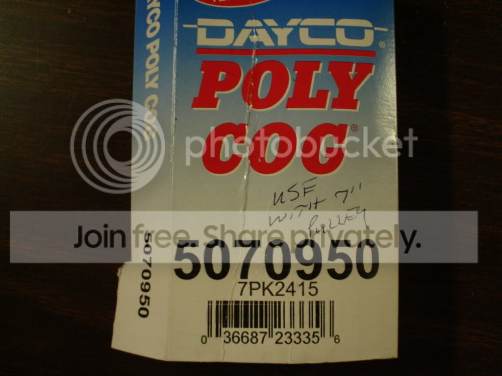

The belt I took off was the original Roe belt...has about 15K miles on it...the seam where the belt ends were stiched together were splitting...probably would have broke within a few thousand miles...you might inspect yours Prof..
BTW..if you go with this pulley and have the Roe SC with the STANDARD Roe 5.6LB pulley (PSI with 7" pulley will be 11LB+) you will need this belt...
Thanks Larry:rock:
