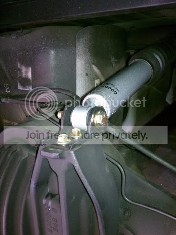

Kicker Shock/Anti Wheelhop shock on a Quad Cab (lowered)

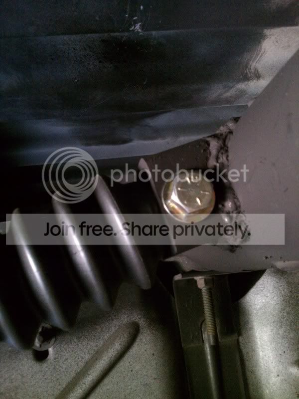

Looks good by the way, well not the welds. :)

The bracket that goes to the rear end cover I got with the shock from Justin, but can be easily made as well.
The kicker shock from the 10 isn't just a regular ole shock. The valving is very tight and has no rebound really. Just tight valving that doesn't let the shock piston move fast but rather take the hit from the differential.

Not the same Justin. (ArrestMeRed) Justin near me in Waco. He took his off since he had Cal-tracs and is lightening his truck.

Just finished doing this mod to my truck. So far I'm pleased. I tried to Fab mine up at more of an angle to possible help with axle wrap, but its not at an angle to do that. I'm going to look at trying to mount it in the other direction, pointing towards the rear.
