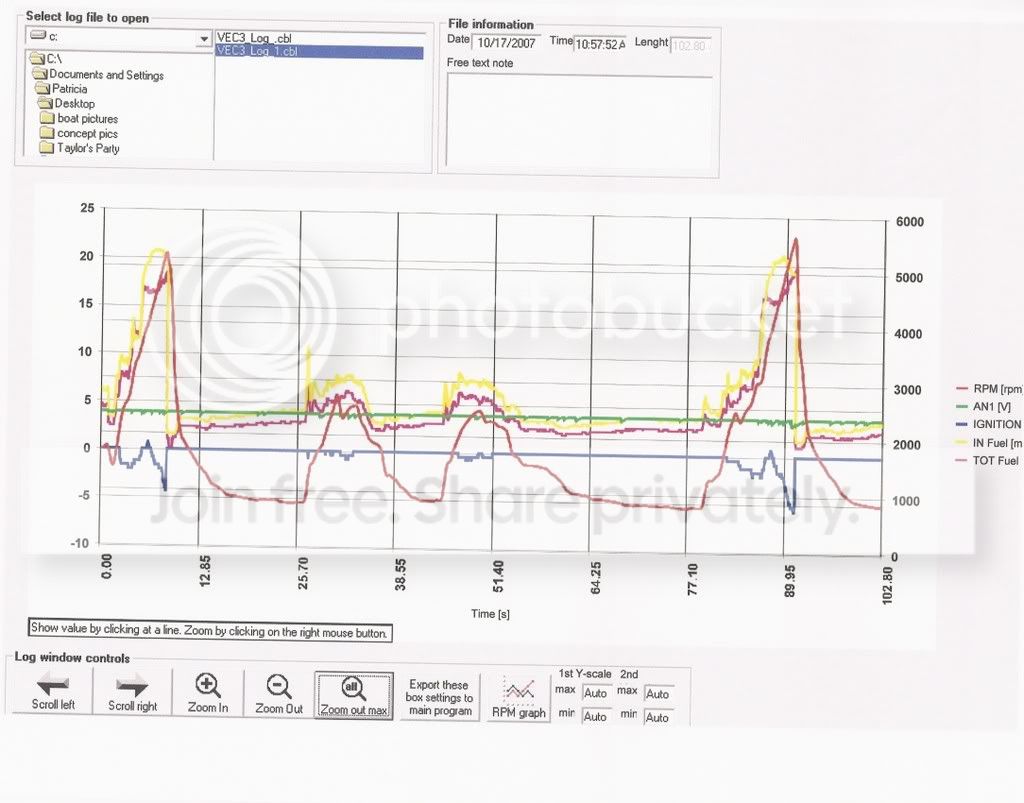

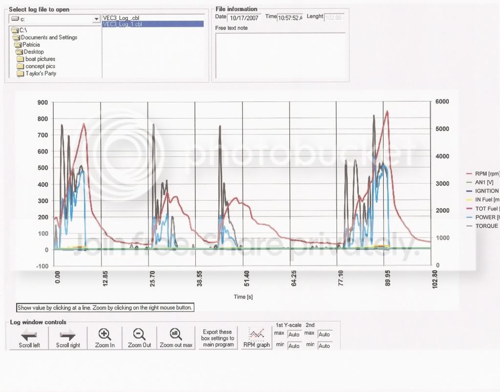

Here are my data logs from todays runs. I don't know if the horsepower and torque readings are accurate off the software. I had to get off the gas once it pinged the first time. Sean sent me a new file to upload into the VEC3. I will experiment some more tomorrow. So far I've turned up the meth to 100% at 5500 rpm and retarded 1 degree of timing starting at 4800 rpm. All I can say is that it is a night and day difference in power. I drove the truck around today and it had been raining, you can't even get into the throttle a little bit because the tires brake loose. The power is really impressive.

Looking at your logs, thats one balls'y tune on stock internals & 10lbs :) . Record IN3 w/ Vec so we can see your MAP readings....
Be careful man, that looks very agressive...Let us know!
